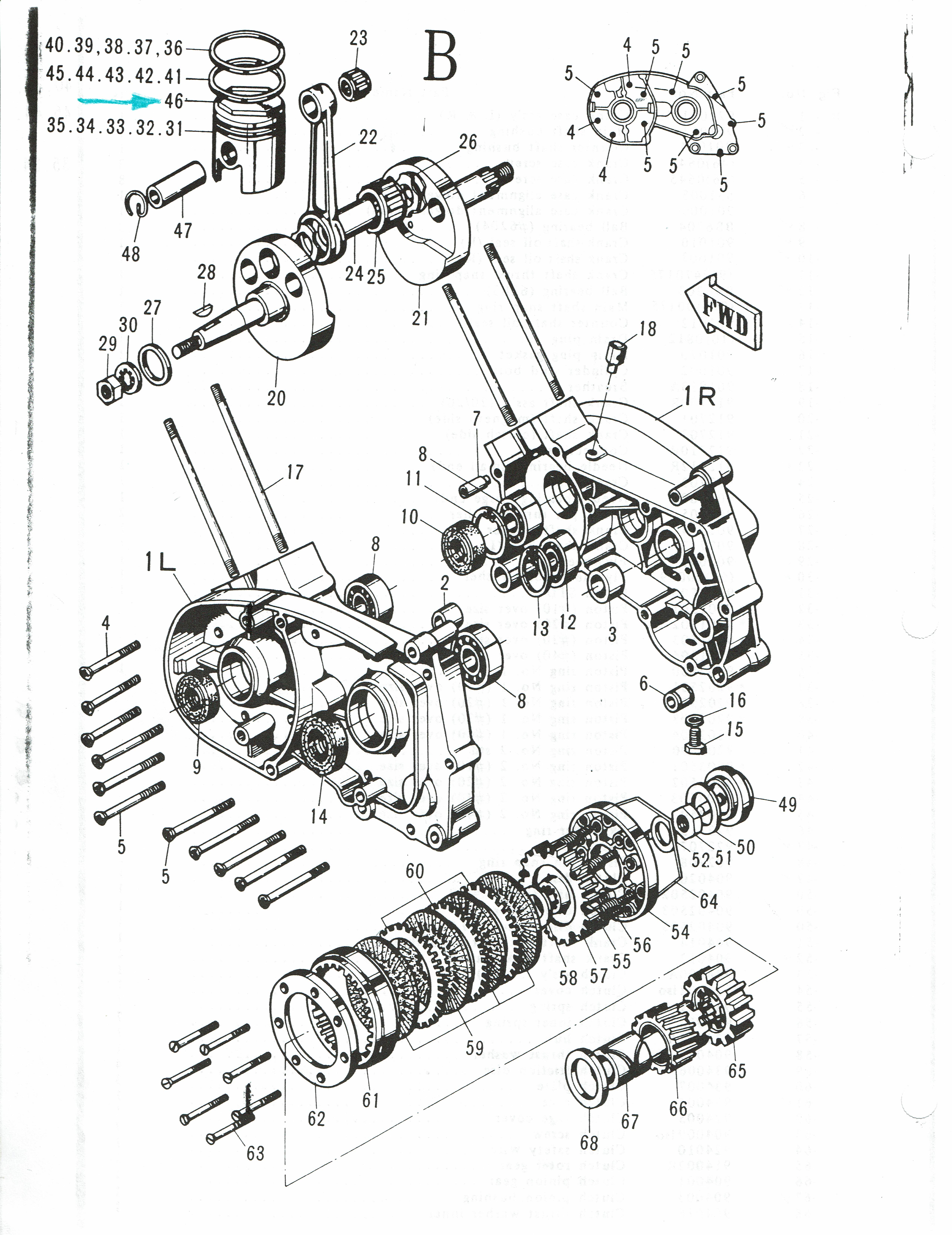

I've just installed a piston & ring set that includes the Expander Ring, Number 16 on the exploded diagram shown in this post.
I've never installed a piston set with one of these Expander Rings before.
It's quite a trick to get the Expander Ring and the Piston Ring aligned with the anti-rotation boss in the piston groove.
That's done, but the FIT into the cylinder is quite tight.
It makes the ring drag on the cylinder greater than I'm used to.
Yep, there's plenty of ring gap and the piston clearance is on the order of .0025"
But that lower piston ring with the Expander Ring under it really pushes hard against the cylinder wall.
Does anyone have direct experience installing a piston & ring set with the Expander Ring?
Al Harpster
Posts: 308
Re: Expander Ring part #922715
Post by Al Harpster »
Sorry, I meant number 46 on the exploded diagram, not 16
