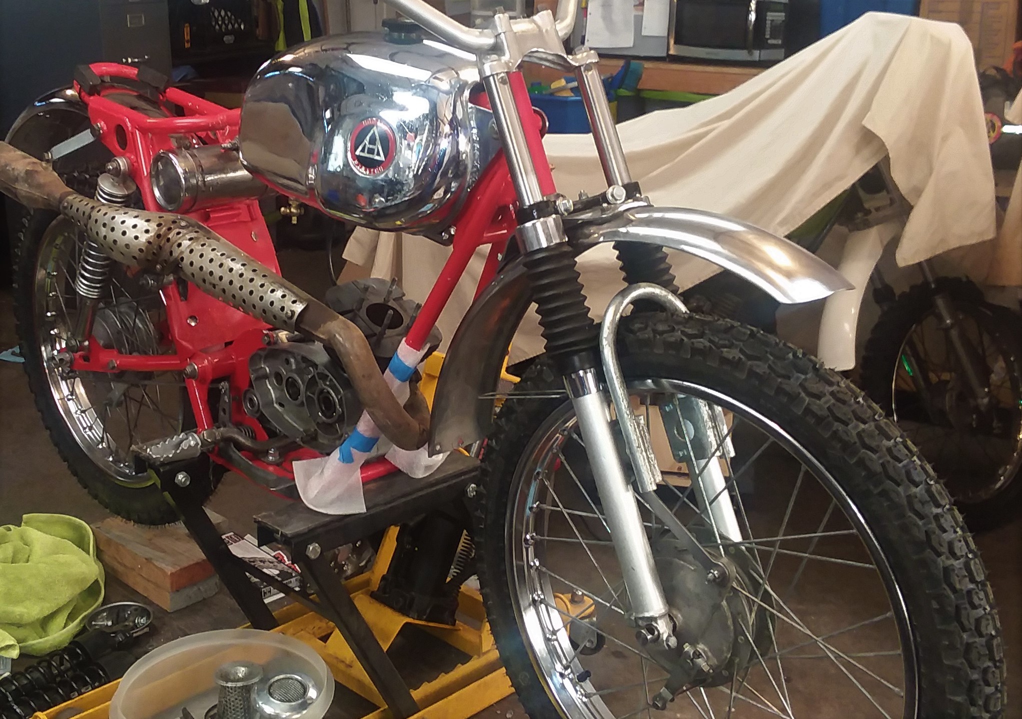

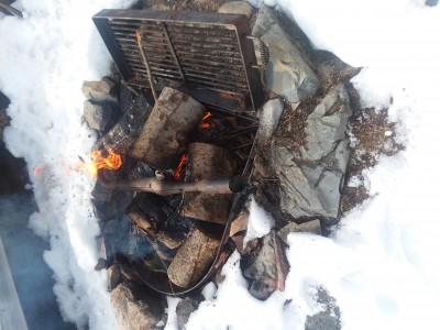

I have been working on a project (BITSA) bike for my grandkids to learn to ride. It's a model 92 Ace 100 without any lighting. It will have a high front fender, a model 93 Super Rat fuel tank, seat and gearing (straight cut primary). The exhaust pipe is from an Ace 100 B+. The roller is now complete. The seat (fiberglass seat pan) is at the upholstery shop. Next up is pipe fitment and cleanup. Here is a picture of the pipe test fitment and then the bbq. Two stroke smoke, it's what's for dinner!

Dale! Gotta love that pipe BBQ surrounded by snow! It shows great intestinal fortitude for the cold! What paint are you going to use for the pipe? And don’t forget some Naval Jelly for the rust clean up! :ugeek: Victor
Re: Ace100 patina build
viclioce wrote: Sat Feb 29, 2020 6:11 am Dale! Gotta love that pipe BBQ surrounded by snow! It shows great intestinal fortitude for the cold! What paint are you going to use for the pipe? And don’t forget some Naval Jelly for the rust clean up! :ugeek: Victor
The pipe will get some brushing, sanding and a crack repaired then treated with my favorite brand of naval jelly, Krud Kutter Must for Rust gel.
Then painted with PJ1 Fast Black 1500 degree.

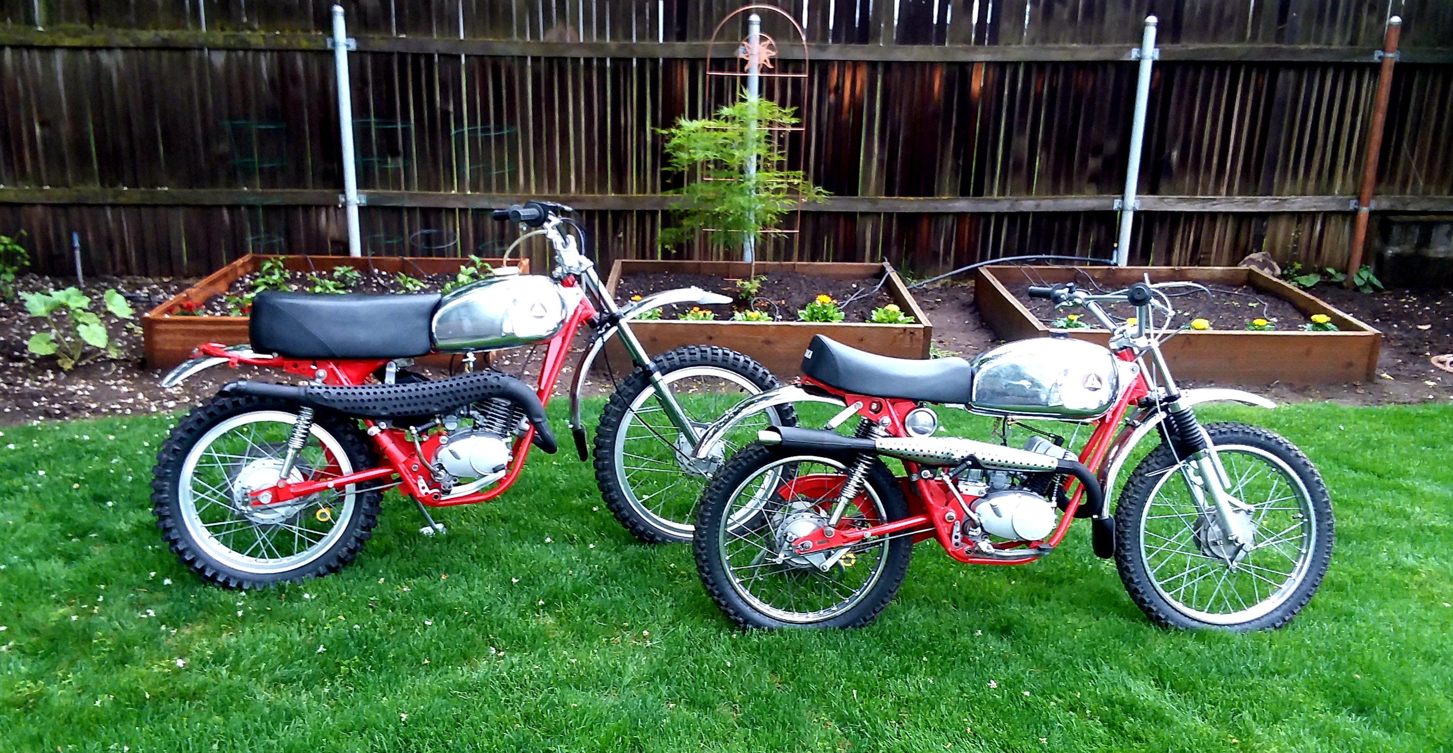

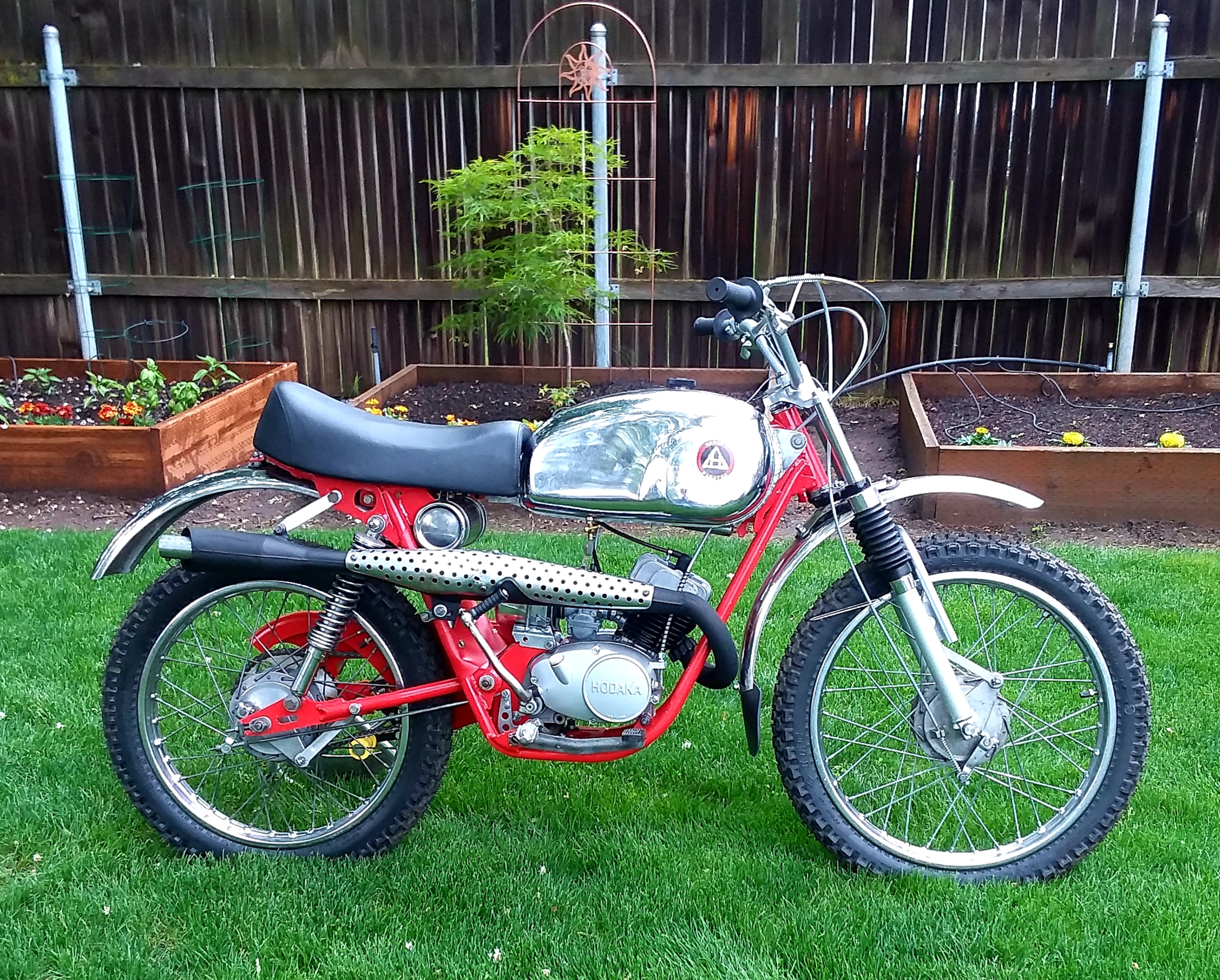

The grandkids BITSA bike is now complete and ready to ride.
Built from bits of;
92 Ace 100 Frame, forks and motor.
92 Ace 100 B+ Exhaust pipe, wheels and shocks.
93 Super Rat Straight cut primary gear, fuel tank and seat.
Ace 100 BITSA bike
Ace 100 BITSA bike

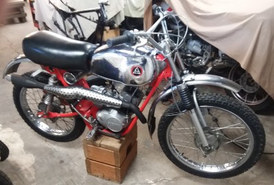

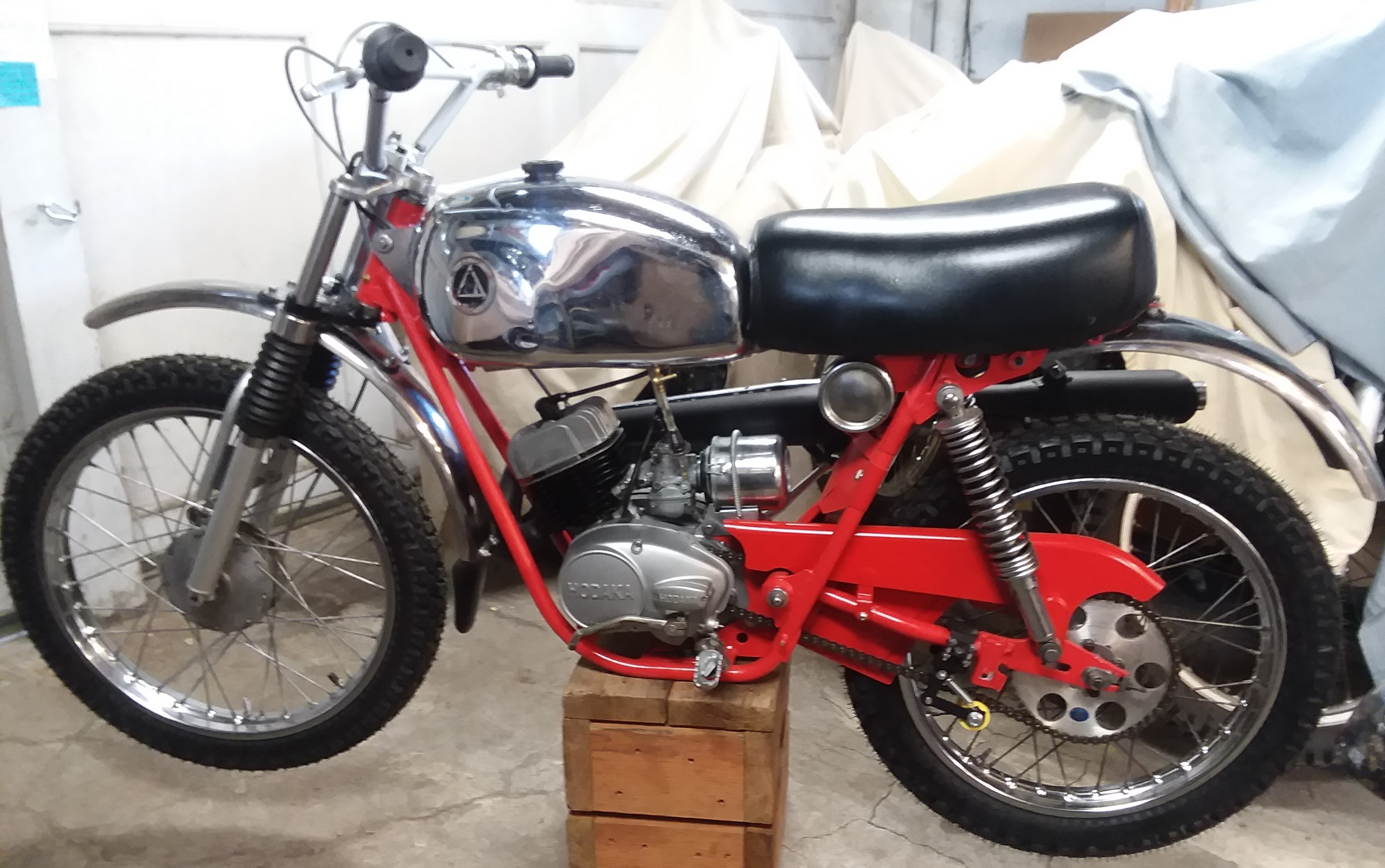

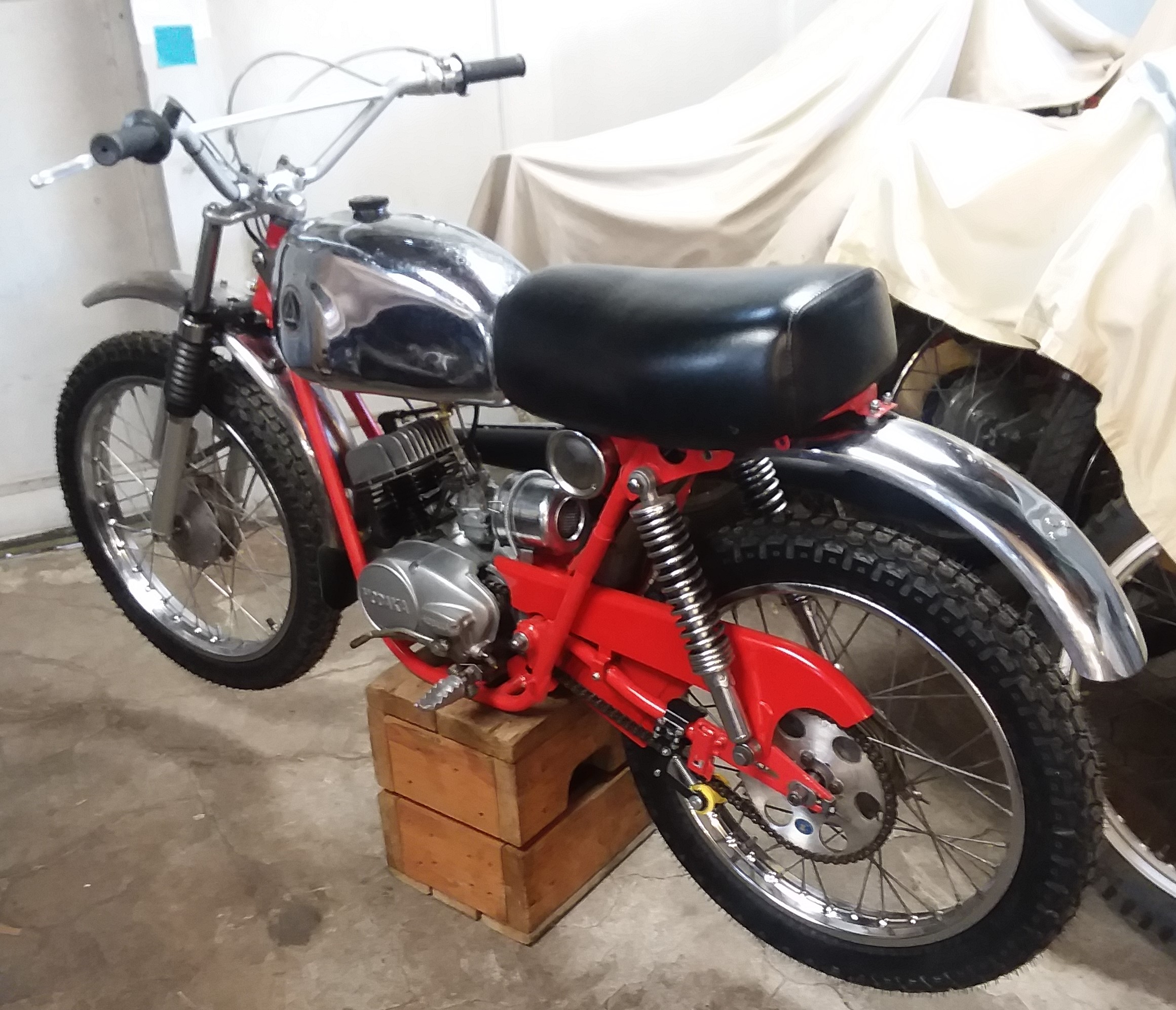

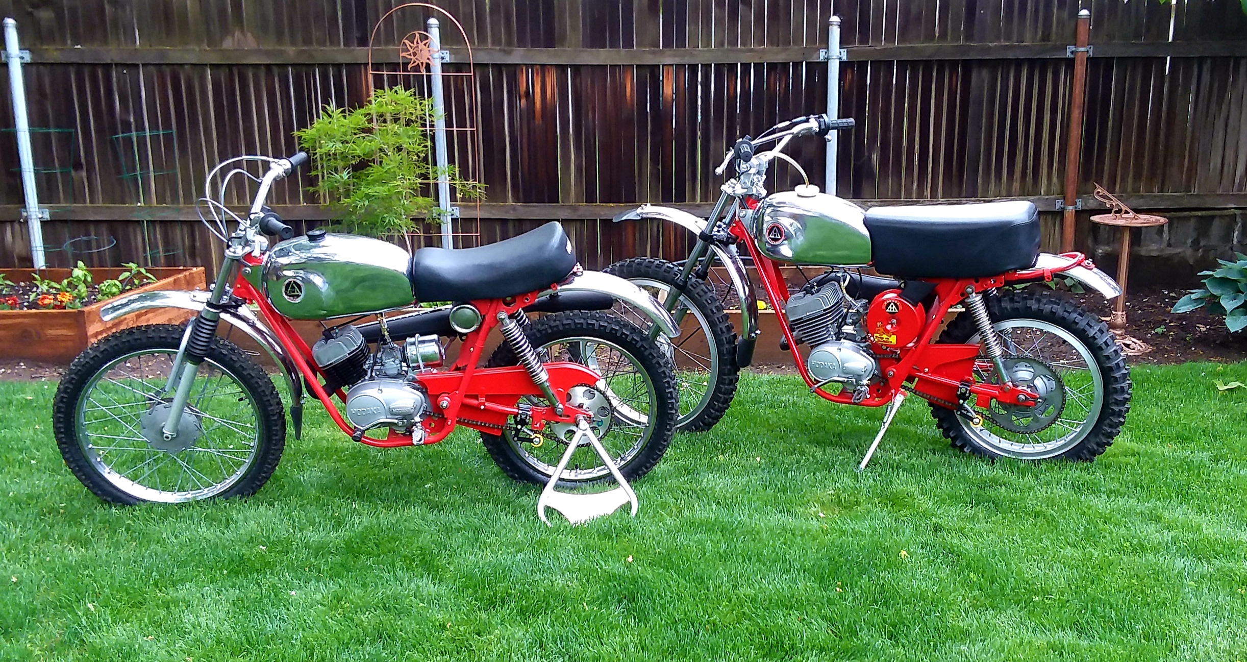

But wait! If the grandkids get a cool red and chrome motorcycle then surely grandad should get a new red and chrome one too! A grandad's BITSA bike.
Built from bits of;
That rusty 94 Wombat frame that had been hanging in the rafters
The exhaust pipe that came from ???
95 Combat Wombat motor that was beat up and thrown in a box, in pieces, who knows how many years ago.
95 Combat Wombat mud catchers that had been beat up horribly at some point.
95 Combat Wombat fuel tank and had a failed Kreem liner in it and now has a fresh Caswell liner installed.
(What a task it was to get that Kreem liner cleaned out!)
Combat Wombat BITSA bike

Beautiful Dale. Is it a conicidence Grandfather's bike has the poofier Ace seat? :)
PS- how did you get ther Creem out of the tank? I have a DS/CW tank that is full of the stuff. I'm a Caswell fan as well.
matt glascock wrote: Wed May 06, 2020 8:26 am Beautiful Dale. Is it a conicidence Grandfather's bike has the poofier Ace seat? :)
Thanks Matt. The seat on mine is actually a very firm and very tall seat custom made for me. Not the most attractive on a Hodaka but gives me the elevation that I really need.
As for the Kreem removal, I started with the recommended (by Caswell) paint stripper containing methylene chloride. Oh what a total mess that made! I won't do that again. After the paint stripper I flushed the tank and then filled it to the brim with 2 gallons of Acetone. I checked it daily and it took 4 days to dissolve most the remaining Kreem. I drained it and added a pint of clean Acetone and several handfuls of misc screws and small bolts. Shook and shook and shook some more. Drained that and pressure washed it.
Best advice that I can give would be to never use the Kreem product. It works great until it doesn't and then you have a mess!

The photos seem to show a bit of development on the Husqdaka seat. It seems to have evolved to slightly overlap the rear of tank. That configuration is great! Really good for sliding forward in the MX corners without pain (when the brain remembers to do that) AND in addition to the extra cushioning while sitting - the extra height is wayee helpful for the transition from sitting to standing. NICE scoot!

Bullfrog wrote: Wed May 06, 2020 3:16 pm The photos seem to show a bit of development on the Husqdaka seat. It seems to have evolved to slightly overlap the rear of tank. That configuration is great! Really good for sliding forward in the MX corners without pain (when the brain remembers to do that) AND in addition to the extra cushioning while sitting - the extra height is wayee helpful for the transition from sitting to standing. NICE scoot!
Thanks Ed. Function over fashion is my motto.
