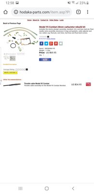

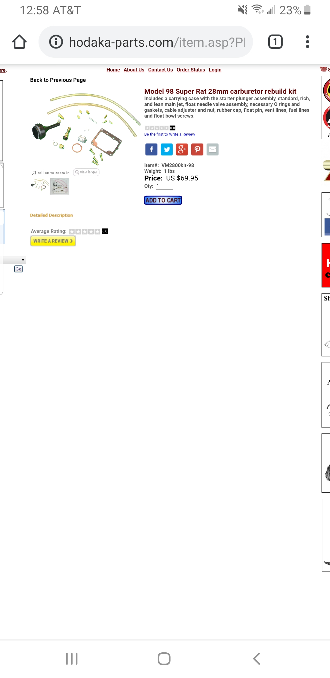

Rylan. You’ve not listed the parts for your carb. What size carb does your Squirt have? I know my Ace 100 has a 20mm while my Road Toads have 26mm. You have listed the incorrect bikes/carbs.
Is your bike a Model 96, with a chrome toaster tank, or a Model 01 with a red tank? The Model 96 used a VM20 carb like the Ace, while the Model 01 used a VM26 like the Road Toads & is reed valve as well.
Let us know.
Let us know.
Re: Coil will shock me but no spark! (dirt squirt)
Well, if the page shown is your carb then it’s a VM26.” for a Model 01 Dirt Squirt. That would be the kit you need, assuming the carb set up matches the picture and has the reed valve assembly as well.
The motor oh my bike came off a super rat , i have a euper rat motor on my 01 dirt squirt
Rylan that carburetor is a (VM24) part number VM2400. There is a shop manual on ebay now that covers the 90, 100, ____, and the super Rat. the Ace 90 shop manual is primary and the others are supplements. --------------Clarence
