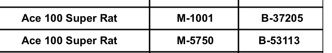

What about this chart, where does it fit? What Model # is it going to be?

Yes it is not in range. The first group of super rats in 1969 began with 37205 and ended with 40004 and then the next batch began with 45263. The book chart is in error it would be nice if it could be corrected. I have always been aware of this and I would guess that others could be aware of it too. ---------------Clarence

Yes it would be part of the first batch produced. I sold allot of Super Rats in this number range at least 10, here in Kalispell, Montana. I threw out most of my records, the biggest number that I sold in this range was 41884, from the few records I still have. I feel if the chart is corrected make all the corrections needed at once, It would take allot of effort, involved members ect. Is it worth it? 95 + percent of the chart is correct my opinion. ---------- Clarence
