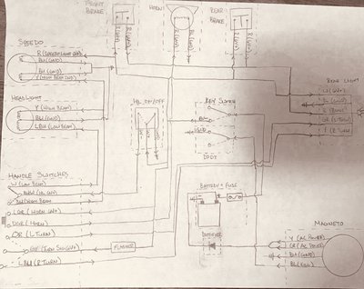

I’m thinking of replacing the stock switch I have (since the key part is broken off) with a simple keyed on/off switch. Off would ground the coil and then On would send the ac current from the green and yellow wire thru the rectifier. Then after the rectifier have one wire directly to power everything and one wire to charge the battery. Electrical stuff is not my strong suit since I’m a Mechanical Engineer so if there is something wrong with doing this let me know! I’ll try and draw up an wiring diagram later today since my set up isn’t using oem parts so it differs a bit.

So here’s what I got for a wiring diagram....I think this should work

Keep in mind that your lights don't care of they are powered by AC or DC voltage.
As I look at your diagram, it looks very similar to the Ace 90 diagram. with the exception of turn signals and a single position key switch. I think it would be easier to use the Ace 90 diagram, if it were me, and then adapt it as you need.
The only thing I worry about with your diagram is that everything is running off DC from the rectifier or battery. The power consumption, I am certain, is greater than the power generation via the magneto through the rectifier. The lighting coils on the magneto only put out about 18W power. Using both the yellow and green spliced together does not double the power. I don't think you are using it that way, but just wanted to make sure. If you use the 15W headlight, 1.5W taillight and then add the 1.5W brake light, your battery will never charge. If you use a higher wattage headlight, your lights will be very weak. Turn signals would be out of the question.
I think there might be a way to use the Ace 90 wiring diagram and use the AC circuit to power the extra power requirements, i.e., turn signals, AND the headlights both. Since the Ace 90 has a Yellow wire that is always on, (AC), it might work and I think the AC circuit would certainly be able to power a couple .5W turn signal bulbs. If you go this route a Voltage regulator would be a necessity.
Long story short, I think the Ace 90 diagram will meet your needs with little adjustment.

The wiring diagram I made probably looks simular to an Ace 90 because I was basising it off of an Ace 100 B+ haha. I agree with what you said 100% but only problem I have is the brake light/turn signals are LED and must be run off of DC. I think the one improvement I could make is instead of combining the yellow and green wire from the magneto (which was just to keep from having a loose wire) I could just run the yellow wire to the on/off switch of the headlight thus supplying it with AC power and run everything else off of the green wire and DC power. What are your opinions on this Roger?

The only thing missing on this diagram is the key switch positions. I had it and posted it before but if I remember right:
For each position:
- 0 (or off): IG => Earth)
- 1: Earth => Bat
- 2: Earth => Bat and C2 => HL.
For everyone and for what it's worth: the Ace 90 diagram is the basis for ALL Hodaka wiring diagrams. Each evolution of the Hodaka Motorcycle built on this diagram. If you can spend the time to really understand this diagram, you will find the later models aren't so daunting.
