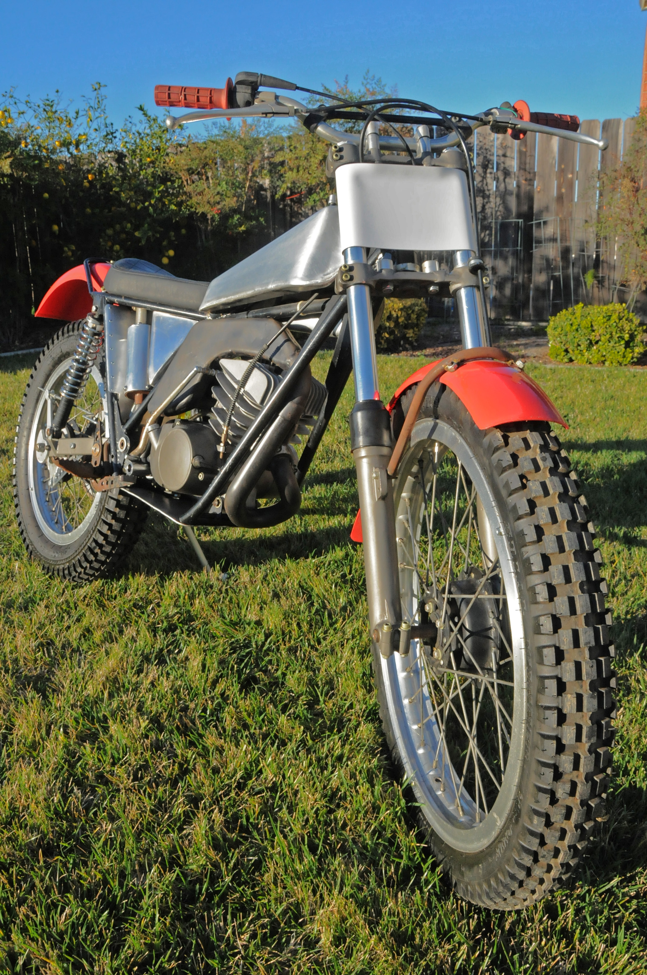

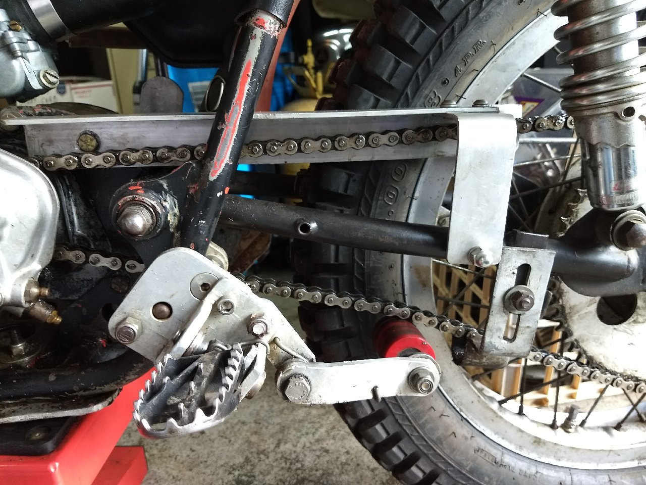

The things I have done to my Ace 100B+ to make it a trials bike were the following.
1. 62 tooth rear sprocket
2. moved the foot pegs back to make front end lifting easier.
2016 look
2016 look
3. plastic tank and fenders.
4. 1.5 LB increase in flywheel weight.
5. IRC trials tires. 2.50-21 front, 4.00 18 rear.
6. skid plate.
7. custom small seat.
8. Chain tensioner
9. Optional; Read valve, 24 mm Mikuni, Webco high compression head.
10. lengthen the swing arm by 2 inches.
chain guard and tensioner

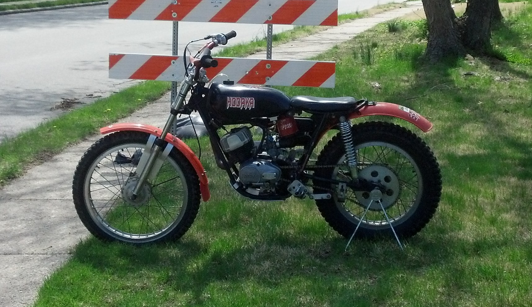

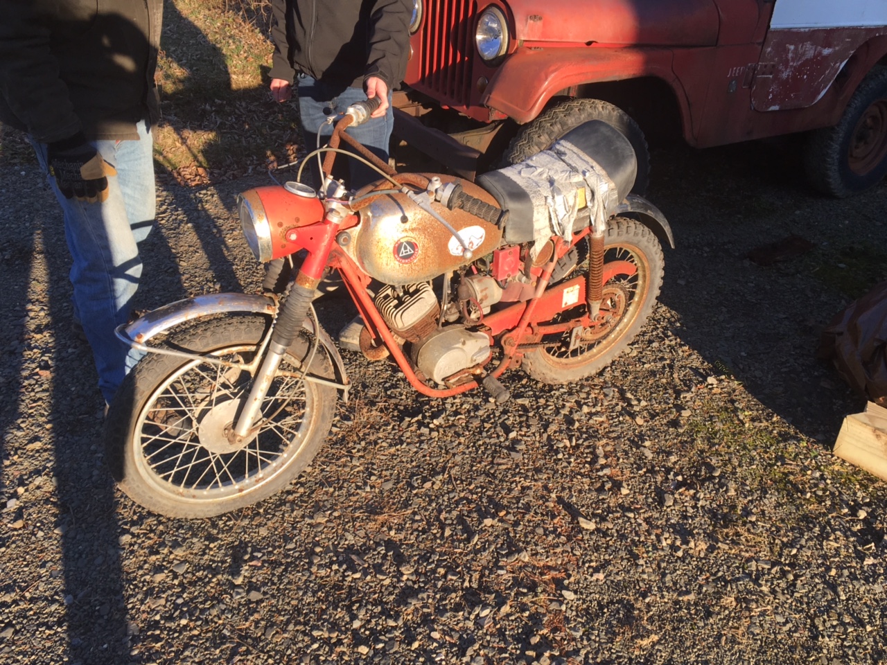

What model is this bike? Make a good Trials bike?
Re: Hodaka Trials
Looks to be an early Ace. Frame and motor numbers would narrow the model and year.
Re: Hodaka Trials
Dozerash wrote:What model is this bike? Make a good Trials bike?
It looks to be a 1968 Model 92 Ace 100. I will let someone else comment on how it would be for a trials bike project.
