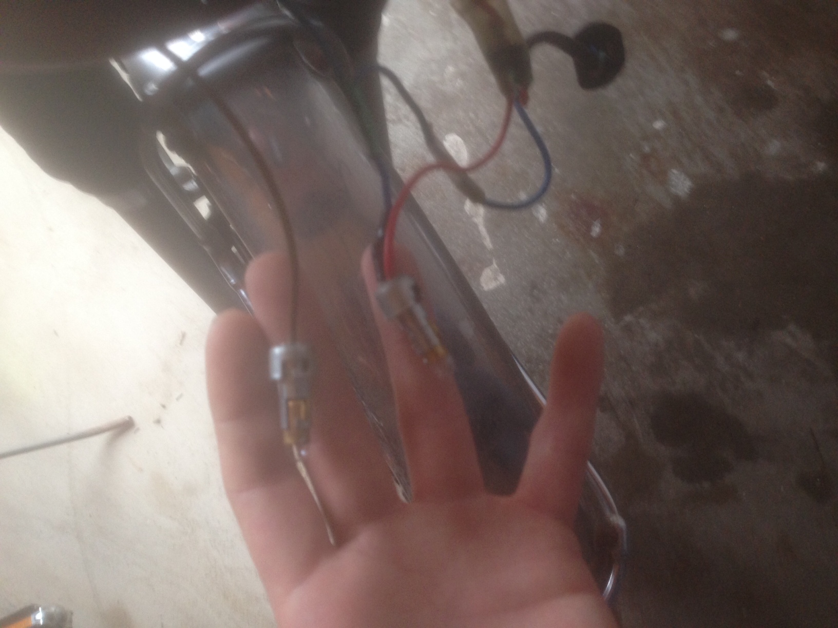

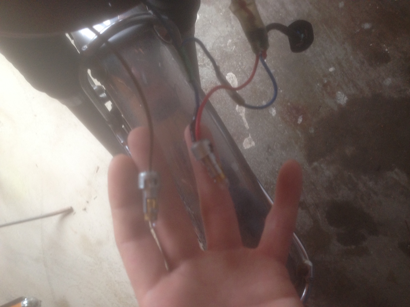

2. It seems that the previous owner did some rigging but the end result is only two terminals(instead of 3 prong), and I couldn't get the headlight to work. I've traced all the wire back and everything seems to test OK, but no power to the light. I've also confirmed that the headlight bulb does work(by connecting directly to batter). I've taken apart the headlamp switch on the handle bars and sanded/solvent the connections to make sure everything is working. I'm seeing some inconsistencies between the workshop manual and the rest of the wiring the headlight housing. It almost looks like there should be a ground wire going between the two speedometer indicator lights, connecting then to the ground of the headlight(light blue wire), then grounding all 3. The pictures below don't don't look too clear but this is what I'm seeing...
Brown wire ends on bottom of speedo light #1(light behind odometer)
Red goes to same spot of speedo light #2(high beam indicator)
Blue wire coming off of speedo light #2 connecting to ground of headlight socket
Everything else seems correct, but I can't even get the speedo lights working(and the bulbs are fresh).
Could it be lack of headlamp to complete the circuit? Grounding issues with speedo bulbs? This is kind of the last step for me to have this thing in good condition, so ANY guidance or suggestions are appreciated.

Thanks Dale. I have scoured the forums to find my answer and have found some insight, but not exactly what I"m looking for. It does not have a toggle switch on the bottom of the bucket and I do have a functioning 3 position switch.

COAce100... it sounds like you have an early Ace 100. You can use the wiring diagram for the Ace 90 to troubleshoot your problem. They are the same except the ignition coil. The Ace 90 used a single ignition coil, the Ace 100 used two. Except for that, they are the same.
On the Ace 90/Early Ace 100 machines, you only have brake light, (not tail light, only stop lamp with brake engaged), and horn with key in first position, whether the engine is running or not. With the key in 2nd position, engine off, you have the same.
The stop lamps and horn operate off DC current from the battery. Everything else, except headlight, operates off rectified AC current, regulated by the battery, directly from the magneto. The headlight is operated directly from the magneto and the voltage is not regulated.
Verify your DC circuit is working correctly, then we can tackle the AC side.

Dale, THAT must be what I'm not understanding. I didn't realize that some were powered AC and others DC. I have the tank off now as I'm having some corrosion fixed and have been working on the electrical with out the bike up and running. Duh. Thanks so much!
