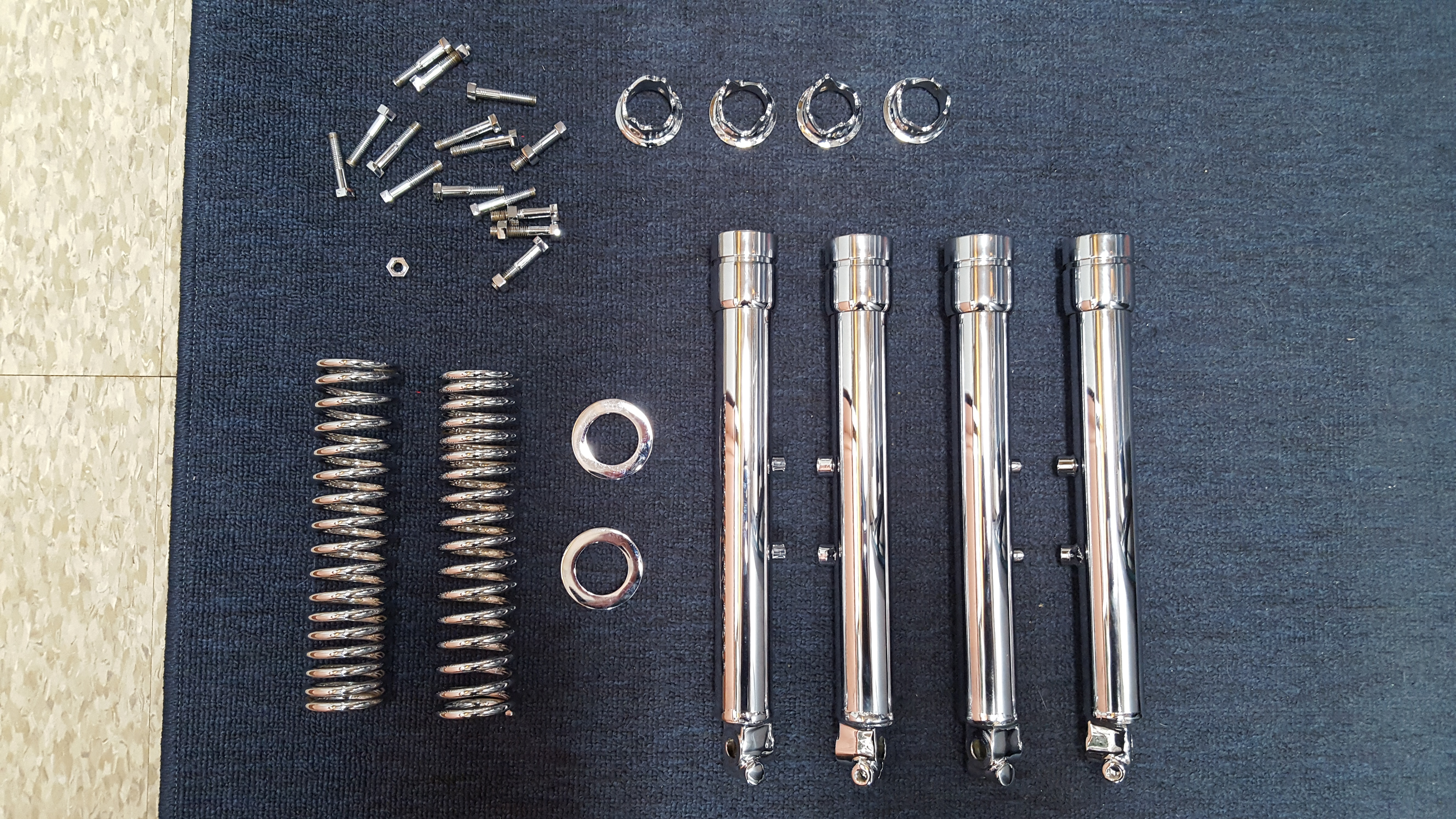

Just got in some more goodies from Salt lake chrome. Everything looks great, especially that tank. This tank is another one Daniel Gromm removed all the dents from. You cannot tell it was dented. Look at that chrome job salt lake Chrome has done on it. Just gorgeous. Only $200.00. If I tried to get that done in Houston, Texas they would have charged some ridiculous price. Those fork tubes are really nice also. I had some problem with chrome getting on areas where it should not have been, which caused some interference when you go to screw the seal gland onto the fork tube. But I fixed that problem and they will work great now. I will do a post about this problem and how to fix it in the future. That way, if anybody else sends fork tubes off to have them rechromed they will not have this problem. In this batch of parts there are several springs for rear shocks, rear shock spring adjusters, and some washers that go on the rear shocks. I will use them with some Westtek Mfg. shock bodies to build me another pair of 99% model 93 shocks. There is also some rechromed bolts and nuts for triple tree clamps. That tank is really clean inside also. Thanks Guys

Zoom up on that tank to see how nice that baby came out. Man that's nice! I will adhere a couple of badges on it and install petcocks etc. and put it on pretty soon

No, Daniel Gromm of Paintless Dent Removal in Santa Rosa, CA charged me about that much to remove the dents. It had about 6 dents in it, not real big but very noticeable. Plus the rechroming and shipping about $500 at least total cost in it. Inside is real clean, no rust.

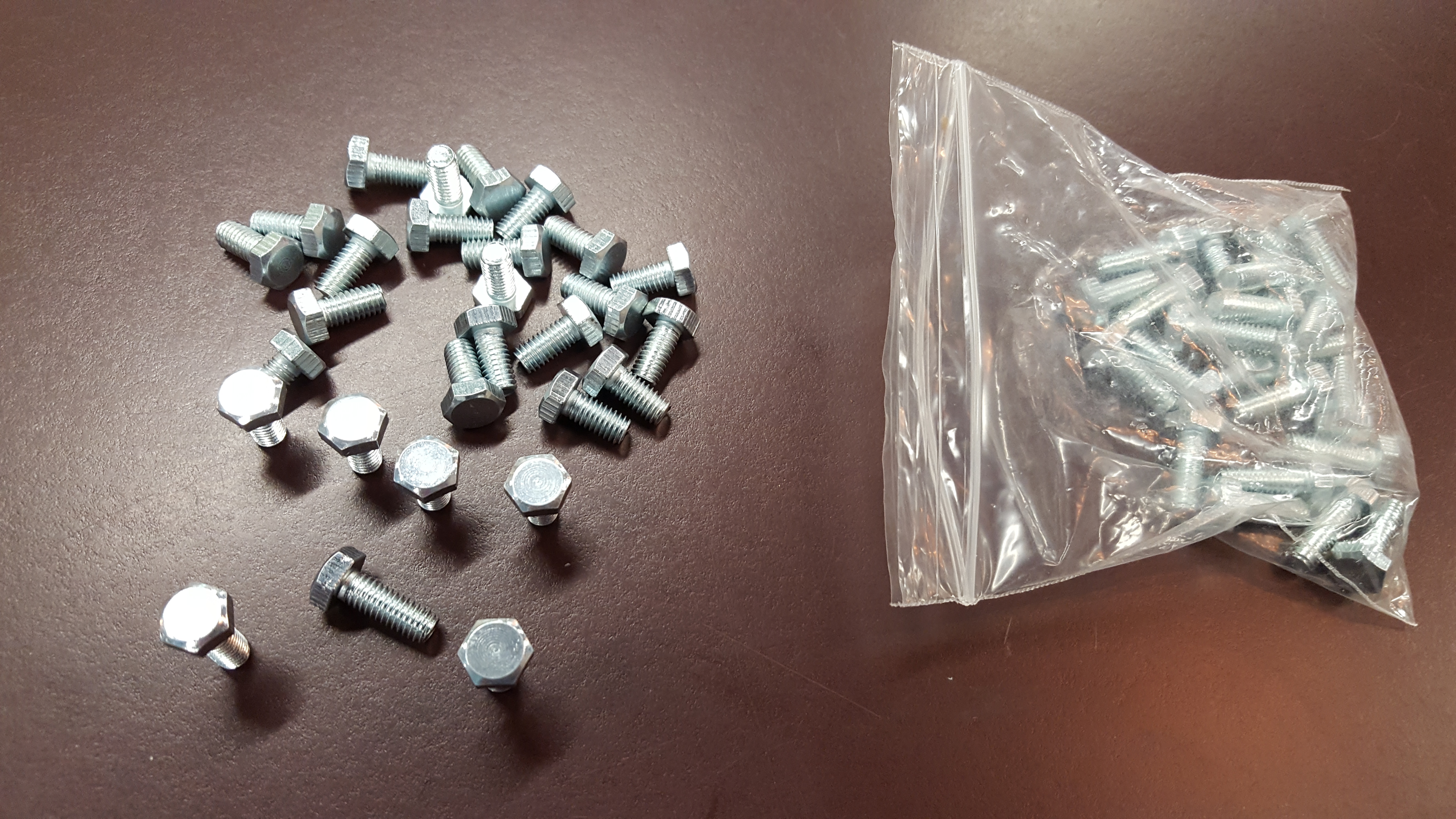

Joe Ormonde had posted previously about buying 6mm bolts that have a plain finish on the heads just like OEM Hodaka 6mm bolts had years ago. He said that Motodad24 sold them on Ebay for about $15.00 for 25 ea. including postage. I ordered about 75 in two different sizes. I need them for my twin Rat resto. Especially for fenders and a few other places. They came in today and take a look, Just like OEM Hodaka plain heads all right. That's great. Great reasonable price also. None of this buck a piece nonsense. Yeah, I want it to have original fasteners like it came with. Evidently Yamaha had these same plain heads according to this guys Ebay store info. Probabbly others as well. Thank you Joe Ormonde for this great tip!

Cool or what !!! I`m buying the 125 bolt kit . Covers the entire bike. It costs just under $27.00 shipped!! If you buy 2 more M6x16mm packs, you can easily have enough bolts to restore 3 Hodakas with a grip to spare! And, they are spot on IDENTICAL to the factory bolts.Joe Ormonde.

125 bolt kit, Hmm. Well, all I needed were the 6mm, all the other ones I had them replated. I will check that out also though for the futre. Thank you Sir.

The bolt kit that has 125 bolts are of various lengths of M6 bolts. I need to clarify that. Joe Ormonde.

was perusing other web sites and came across a rebuild of a "steen" some of the bolts were missing so he ,they, went and bought some and put them on a metal lathe to remove the markings on the top then blasted then plated. if you have access to a lathe might be a cheap easy way to get some good looking bolts[ Hodaka Restore - Vintage - ThumperTalk ] i tried to give a link , best i could do ...albert

Right ! I bought some stainless steel bolts, took off the markings and semi-polished them. I actually put a shut off valve onto my DA sander, put a sheet of 320 stickyback paper on it, clamped it in my vise and let it spin ! I controlled the speed with the shut off valve and VERY carefully took off the markings. It semi-polished the bolts at the same time! I also made a stinger for a Model 93 pipe out of a 235 Chevy road draft tube! Those tubes for the ceiling fans work too, but the O.D. was slightly smaller so I went with the 235 tube. Watch Your Pennies And Your Dollars Will Take Care Of Themselves! Joe Ormonde.
