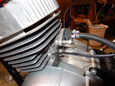

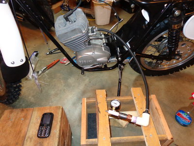

Added note: The parts listed in the Mini Buff article can be substituted for by anything that will hold air. A freeze plug for the exhaust opening works great. Smear a small amount of grease on the rubber surface and it will seal every time. A rubber plug from the hardware store for the intake manifold will work. Drill a 1/4" hole through it and insert a 1/4" barb into it. I use safety wire to secure the rubber plug into the intake and also grease it. It seals well. If your carb mounts with a rubber flange, then PVC connectors can be made that will tighten with the hose clamp. Here are some pictures.
