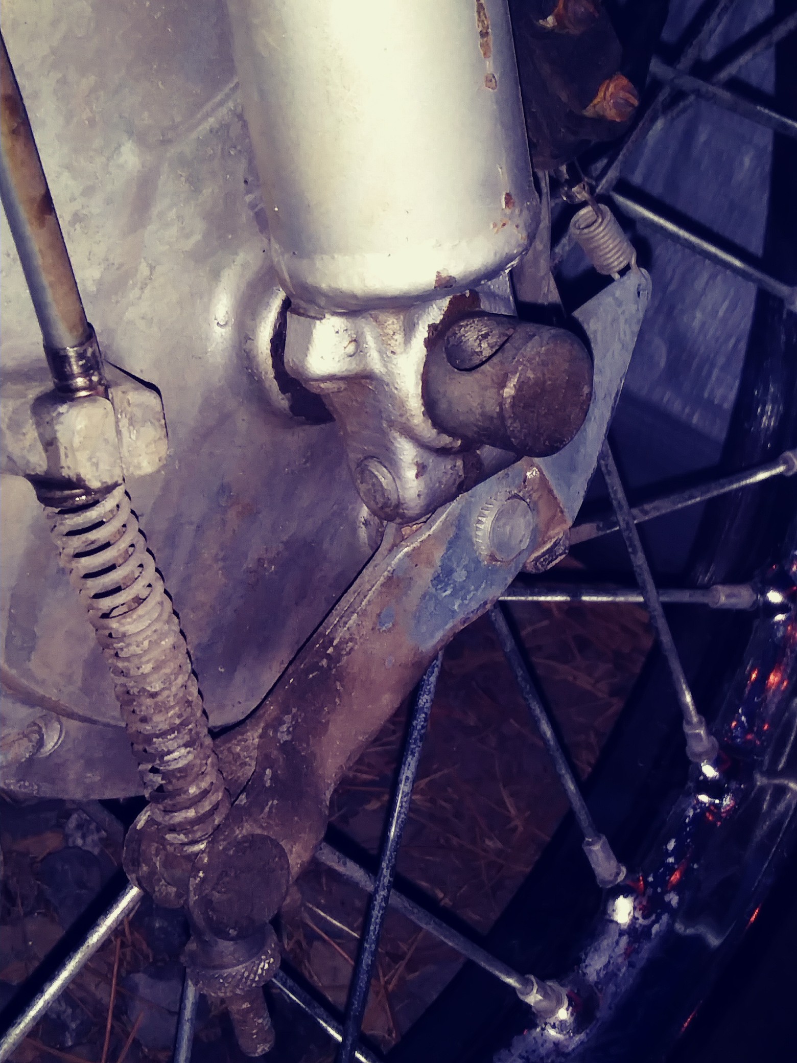

Here's a pic of the broken? off nut/threads on the left side of the front axle, Jack. Thoughts?

nope, look's correct to me. it has a pinch bolt on the other side that secures the axle in place. The axle fits all the way through and threads into this end.
Re: new owner, need advice
Mayhaps I am having a "senior moment", but I've never seen a Hodaka 30mm fork steel slider with a boss like that for the drain screw.
. . . and all the Hodaka front axles I remember simply slide through a holes at the bottom of the fork sliders and have a ny-lock nut on the end of the axle.
So, please forgive me if I am having a senior moment . . . but that doesn't look like Hodaka original equipment to me. (. . . and none of my comments here address the problem of removing the axle . . . )

rlkarren wrote:nope, look's correct to me. it has a pinch bolt on the other side that secures the axle in place. The axle fits all the way through and threads into this end.
So it's threaded into there and there's no nut to hold it on?? That doesn't seem right ... the rear axle has a nut on the other side. But yes, there is a pinch bolt on the other side of the front wheel, under the axle.

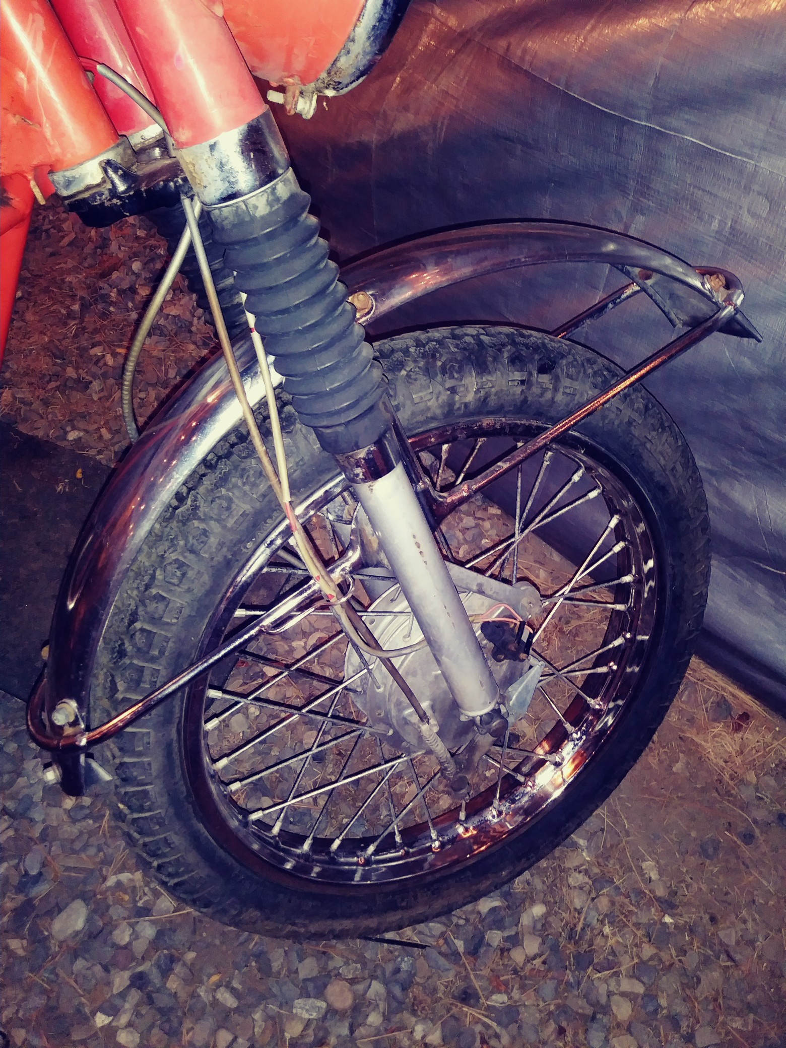

dirty_rat wrote:Those are the "real old" Ace 100 (prior to the "B" models) forks, the ones with fork boots and external spring. I believe they only had 27mm fork tubes.
Yes! It has black rubber fork boots. It says in the manual they're different than the ace 90 forks in that they've been shortened to accommodate the accordion style rubber boots. Do you think I can keep them? Or would you replace?
A mounting "boss" is a generic term describing a threaded socket that accepts a screw/bolt. Another example is found on the inner engine cases. They are the threaded holes that accept the screws used to mount the clutch and shifter covers. The fork boots are and look cool. If they are not torn, use them. I have has good experience giving them a good wash with mild soapy water and a treatment with Armorall rubber preservative. I've also heard that a wipedown with WD40 is effective in keeping them supple and shiny black but I don't have person experience with that.

Rest assured that there is nothing broken or missing on your axle. The axle is threaded into the left fork leg and then the pinch bolt is tightened to keep the axle secure. To remove the axle simply loosen the pinch bolt and unthread the axle from the left leg. To assemble the axle thread the axle tightly into the left leg, then compress the forks a few times to ensure that the right fork leg is aligned correctly on the axle, and tighten the pinch bolt at the bottom of the right fork leg. Many motorcycles use this axle configuration and it is very effective.

loosen the pinch bolts on the bottom of the forks put a screw driver through the hole in the axle on the right side and unscrew the axle

The boots, if the other side looks as good as the one in the photo, I’d keep & use them. Claening is s good idea and so is some kind of rubber protectant. Something you can rub in & the rubber will absorb. Keeps it from dry rotting & checking, which is what usually does them in. Stay original where you can. And if you want them tho look new, get some Doc Brown’s Leather Back. It has a strong black dye in it! ; Victor

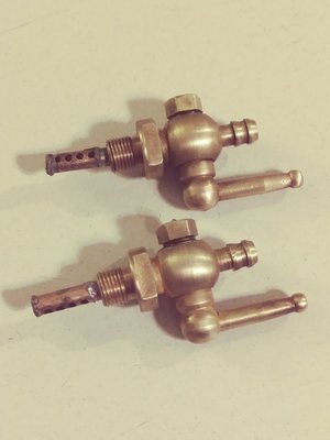

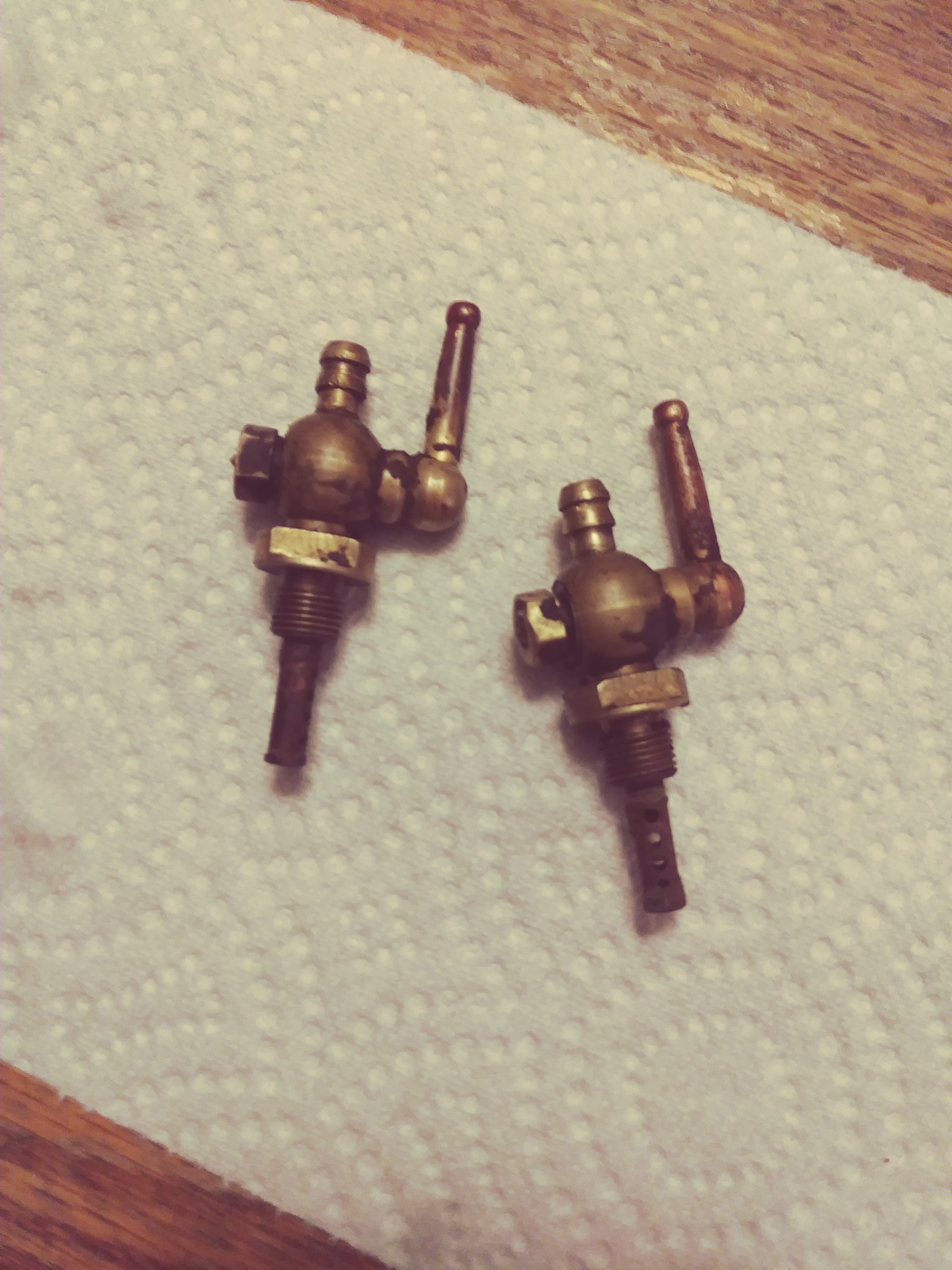

No, I hardly had any time this weekend. It was way too nice out! Had to go for a loooong scooter ride and paddle boarding on the Columbia River. I got those brass petcocks all cleaned up and shiny, tho 8-) they were filled with hardened varnish. They still need a little work but at least they're functional now.
