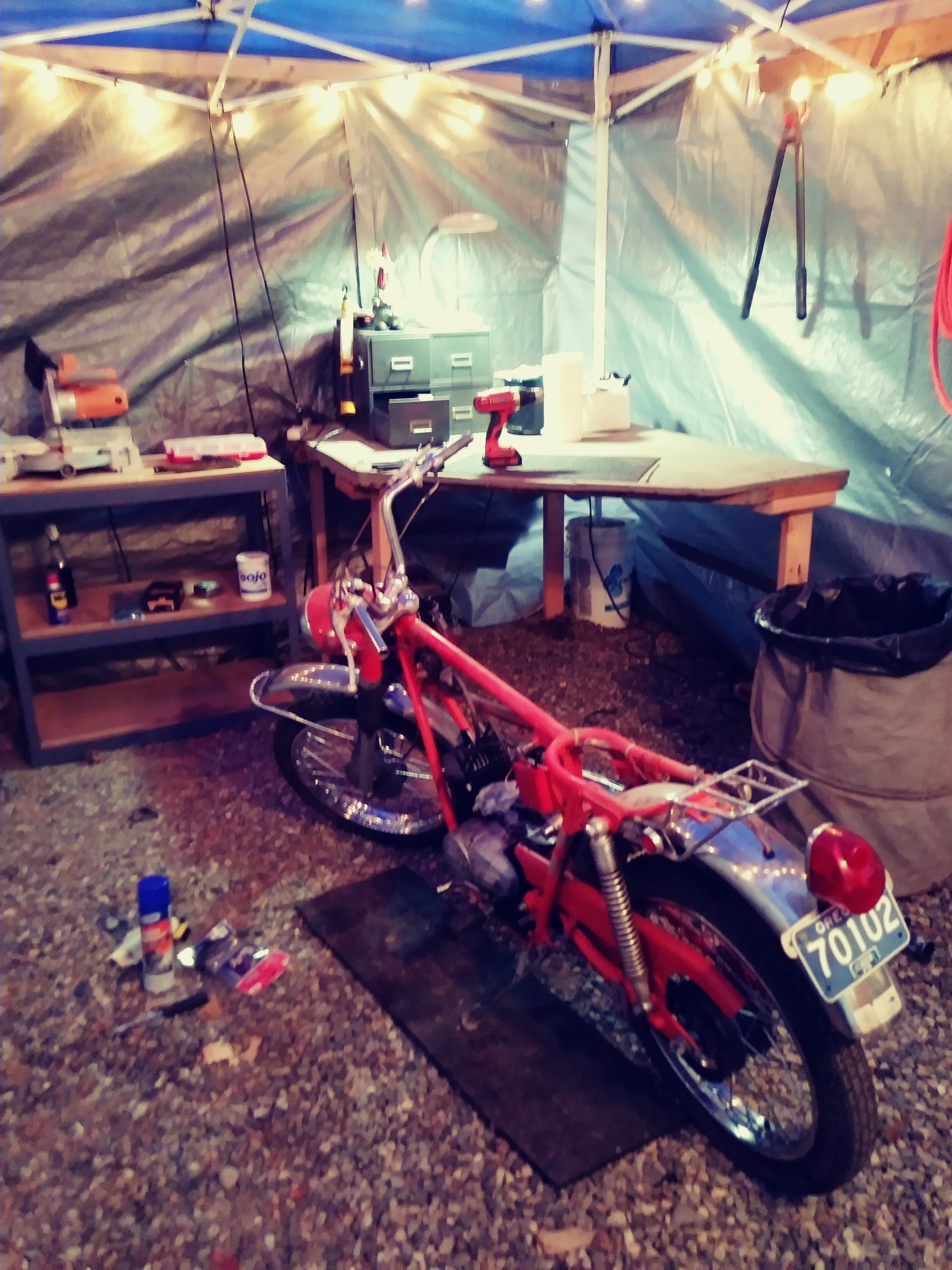

Yours looks about like mine does right now! I'm taking lots of pictures close up and farther away for each section I'm working on dismantling, and then putting the parts in labeled plastic Ziploc bags. I ordered one of those ultrasonic cleaners so when that arrives, I'll clean the parts and re-bag them, then put in separate bins based on which section of the bike the parts belong. I like Victor's suggestion of putting the nuts and bolts back on where they go after removing something, too, and have done that with the seat bolts and fuel tank bolts.

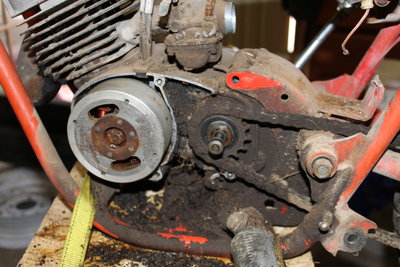

i was going to do a full restore but thats not realy for me. got to thinking i will get it cleaned up and put in good mechanical shape, it looks like i will be going through everything and thats what i like doing, as far as nuts and bolts most are in need of some help so as im going through the bike when i take a part apart like for instance the rear fender i will drop the nuts , bolts washers in vinegar let them sit for a time take them out wire brush the rust off of them clean in warm soapy water then drop them in marvel mystery oil and wipe them down then i can check for damage, bad threads , rounded heads, right or wrong thats how im doing it if some thing needs replace i will . good question and answer about the bolts albert

Wow, that's a greasy, dirty mess! I haven't yet opened that up, but plan to this weekend. Then we can see who's bike is dirtier, lol. I did remove the chain - luckily the master link was the 3rd one I checked. I had to scrape a layer of grime off of each link to find it.
How are you planning to remove all that gunk? Any special products? I've heard about that Marvel Mystery Oil but haven't tried it. A friend suggested it for removing carbon deposits in the top end when I was decoking my scooter, so it must be good stuff.
Do you have one of those ultrasonic cleaners for the small stuff, like the carb and other small parts? I have one coming tomorrow, so I'll let you know how it works.
Re: Organizing
im looking for a parts washer or ill make some thing. then use some" crown PSC 1000 " part washer fluid. the ultrasonic cleaner sounds to high tec for me
