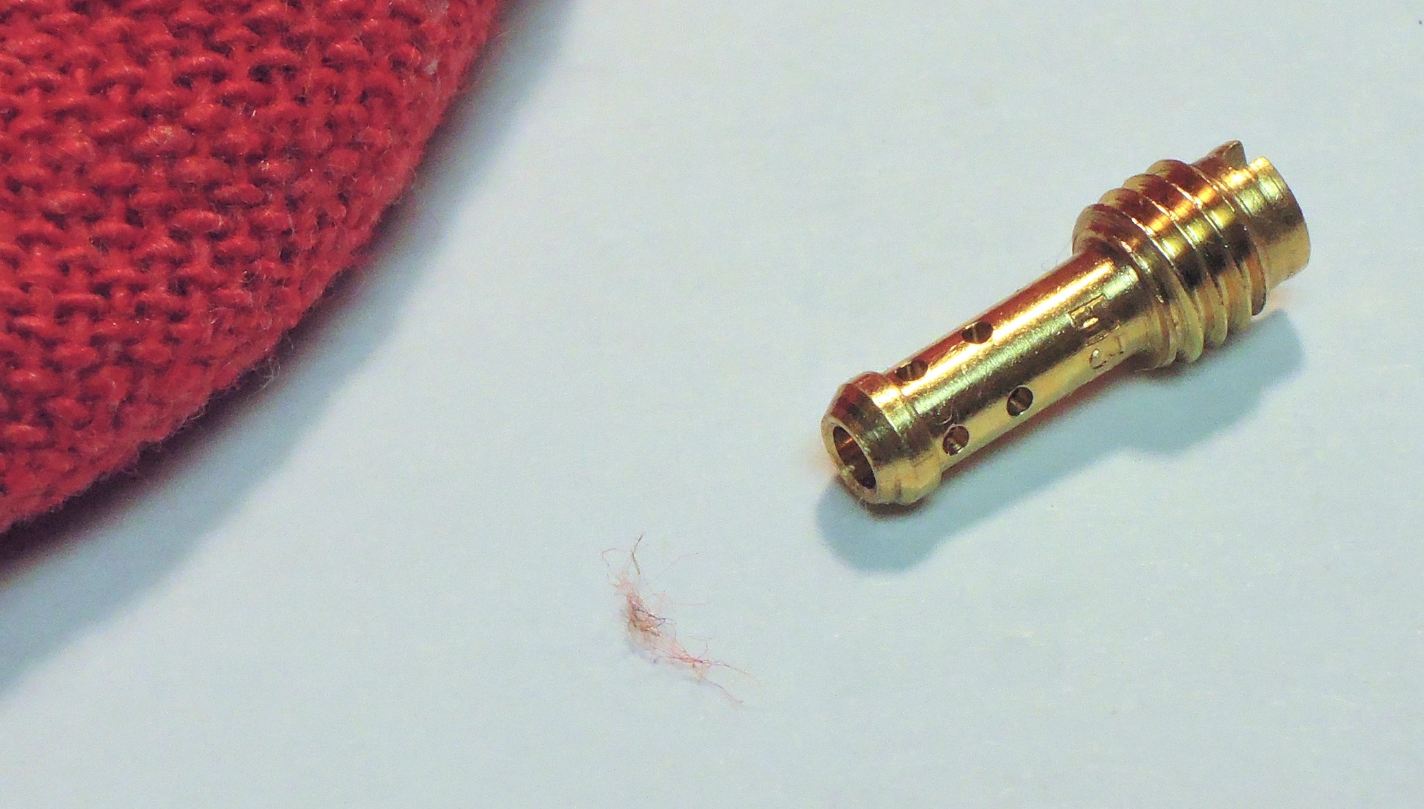

[quote="viclioce"]OK. The damned pilot jet was clogged again! Exactly what causes the jet to clog up and stop passing fuel?
Victor, I was having the same problem and close examination revealed fibers from a red shop rag was the culprit. Even as I tried to photograph the situation to warn others, charged fibers were jumping to the jet as I moved the subjects around. Here's the shot from the Resonator short tech tip. Carb assembly with a red shop rag is a bad idea.
This can be the problem.

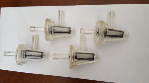

The filters with openings at 90 degrees to each other work nicely for some applications.
Posts: 4870
I found some 90* filters on eBay. 4 for $9.95. Placed an order and will try one when they get here! Good idea! :mrgreen: Victor
Sorry I'm a bit late with these photos. Small and short inline filters can be found with a bit of searching.
Posts: 4870
I had one like your second photo. It's the type I talked about. Made connecting a bit of a bitch because there was too little tubing to connect in between, without making the fuel line flow in an upward direction. I think the 90* one is going to make a big difference in fuel flow. :mrgreen: Victor
Posts: 4870
Jack. The fuel flows finexeuthout the filter. It just didn't want to flow well with the filter because it made the line buckle upwards after the filter. I think the 90* filter ends will give me what I need. And I know I need the filter! Thanks! :mrgreen: Victor

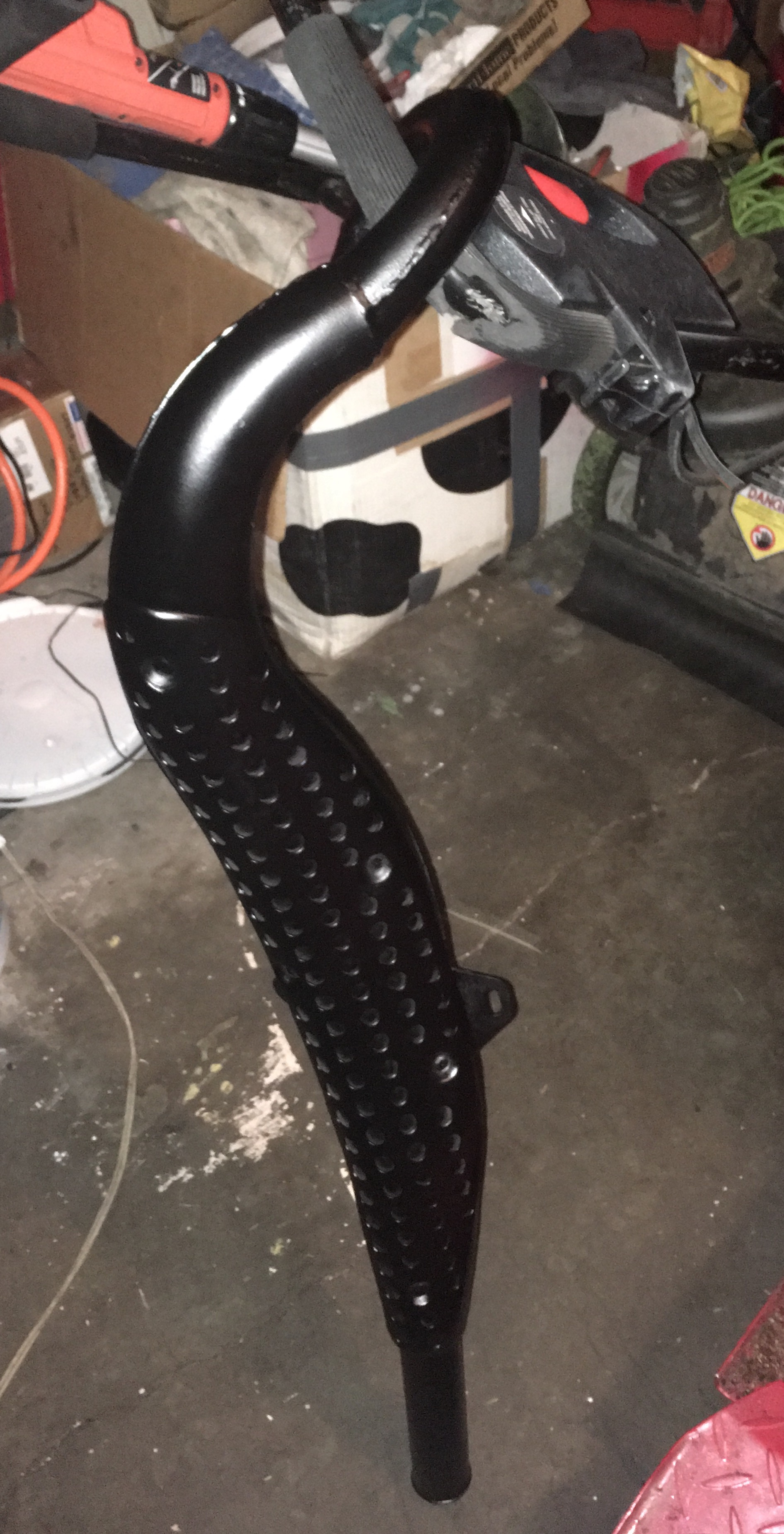

Finished painting the correct pipe for the Green Toad tonight! Glad I got it done! This ones almost done now too!!! :mrgreen: Victor

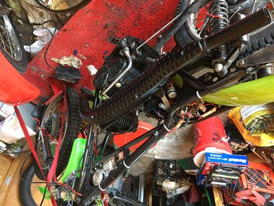

Got the pipe finished & mounted on the Green Toad yesterday. Also buttoned up some of the wiring. Hoping to have wiring finished today. And I still need a set of front turn signals if anyone has a set they can part with! Hoping to get the carb on today as well! :megreen: Victor
