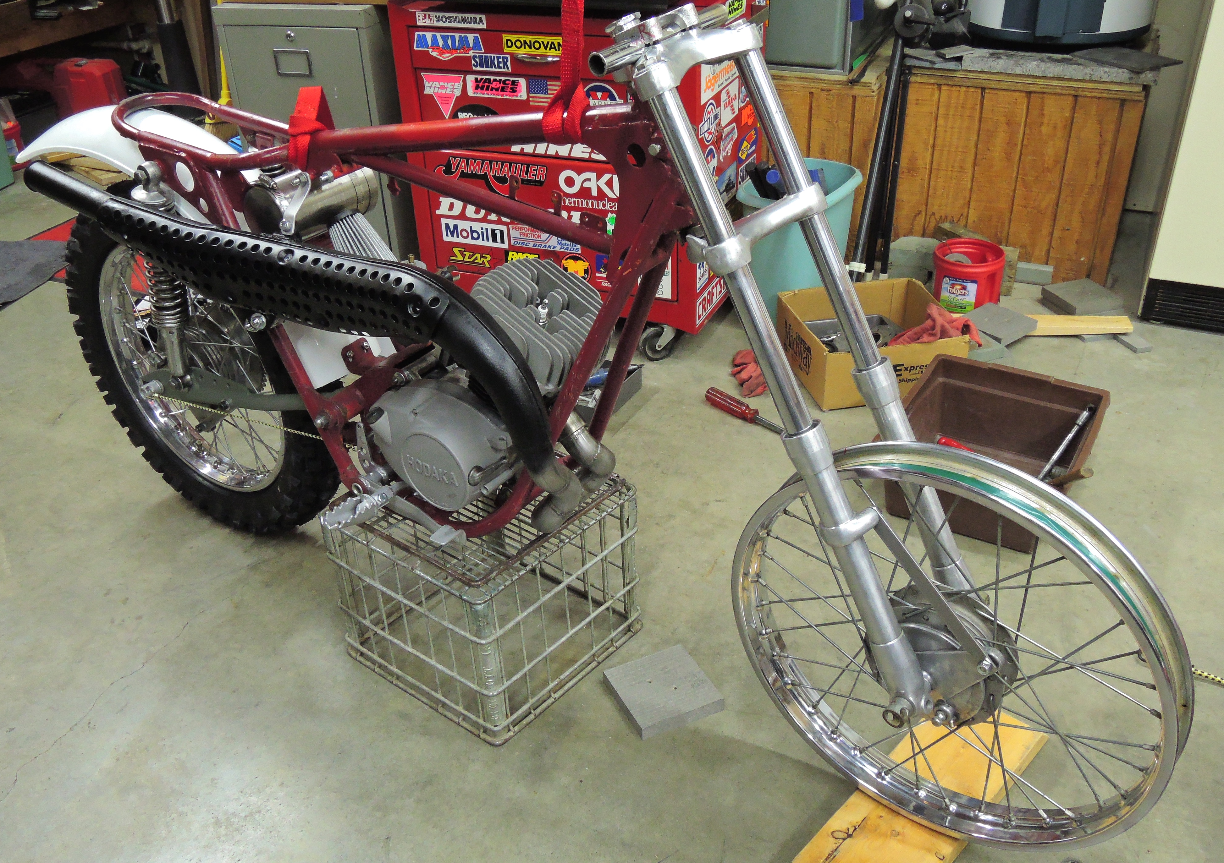

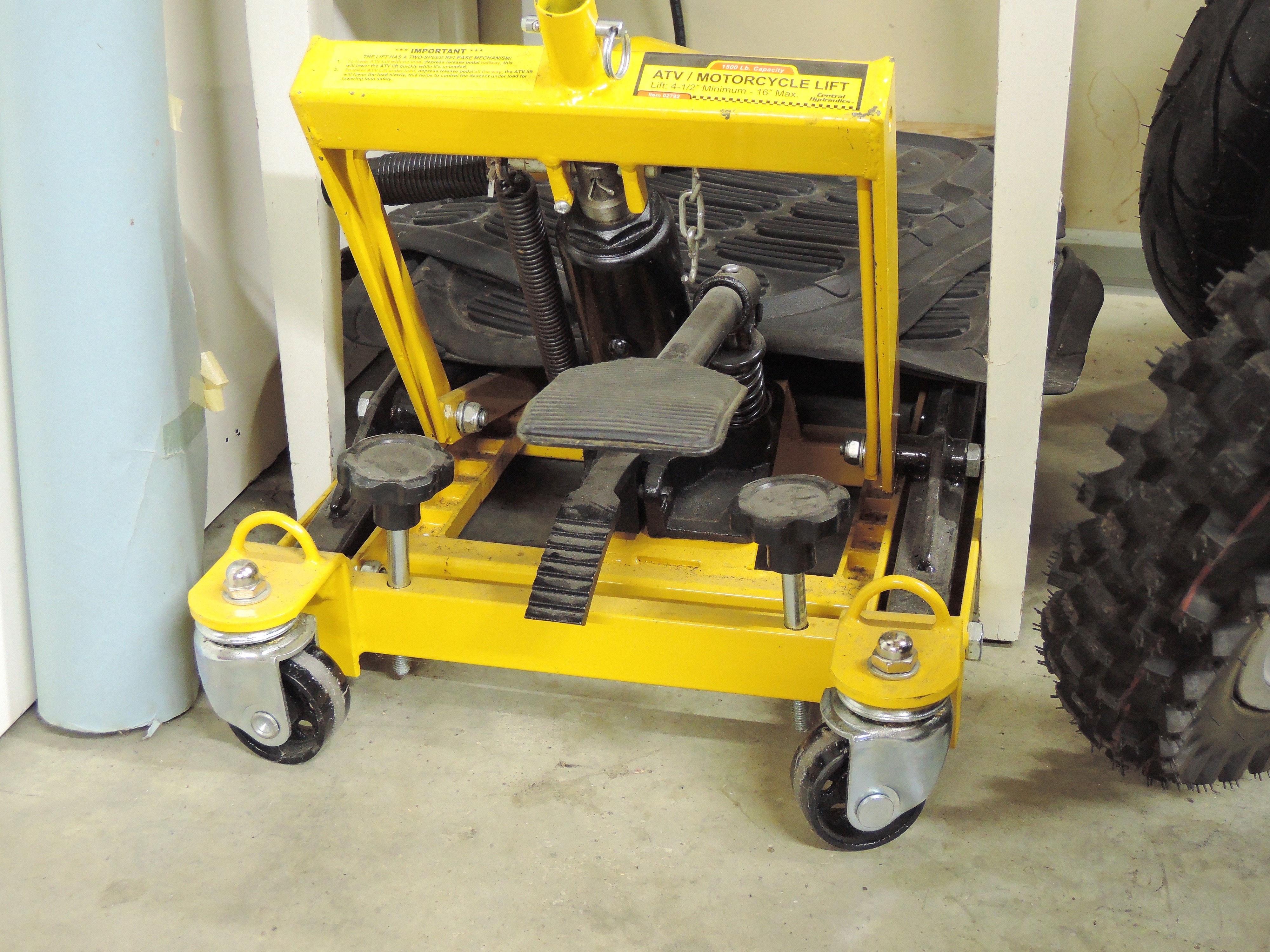

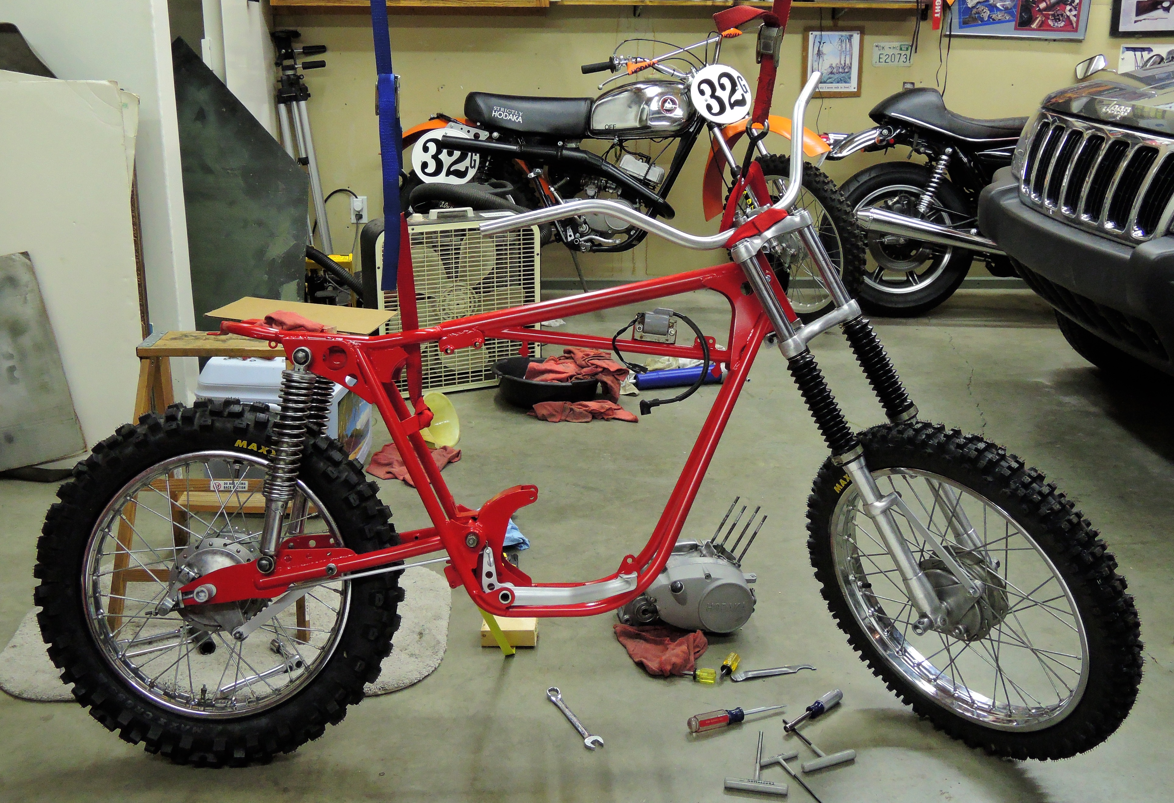

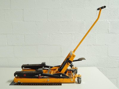

Hey Matt, excellent question. My favorite device is a metal milk bottle crate from our racing days in the '60s. It was affectionally named "The turkey crate" " by the racing crew. It's still with me after all these years. All manual of course but fills the bill 90% of the time. I'm also a fan of hanging for assembly which can have radical changes in height even on one end. I have a large I-beam support across the shop and use tie-downs for such applications. Third choice would be this somewhat clunky Harbor Freight lift (about $100-S150) which is kinda big but stable and really worked out well on a Yamaha XS-650 restoration. When the bike is lifted the whole thing can be rolled around the shop which is plenty handy. More than one way to skin a cat and these are my three methods. Just a few ideas!
Cheap, klunky, big but effective lift
Tie down hanging system
The "Turkey crate"
The "Turkey crate"

Thanks Max. Like many, I too have used a milk crate at the track, albeit a cheap plastic one. Nothing like the elegant, yet heavy duty "Turkey Crate". I love it!! What I really dig is the suspension set-up of yours. I'm going to MacGyver one here in my shop. With the Wombat, I had it on a crate, but when I took off the front wheel, the balance shifted and the bike wheelied off the crate. I barely caught it. With your suspension rig supporting the rear of the bike, that would've never happened. That Harbor Freight rig looks cool and I'm sure really great for a big bike resto but probably a bit intense for dirtbike work. I'm with Zeek. I would have caught the bike with my face if necessary!! Thanks fellas!

Combine the Harbor Freight jack with a drive up ramp and you have your work at the right height. Very stable too. A block of wood under the tire opposite of the end you pull off keeps it from tipping. A zip tie allows the frame to be tied down for removal of both wheels.
The jack is also available in aluminum. That might be nice but also at the expense of stability?

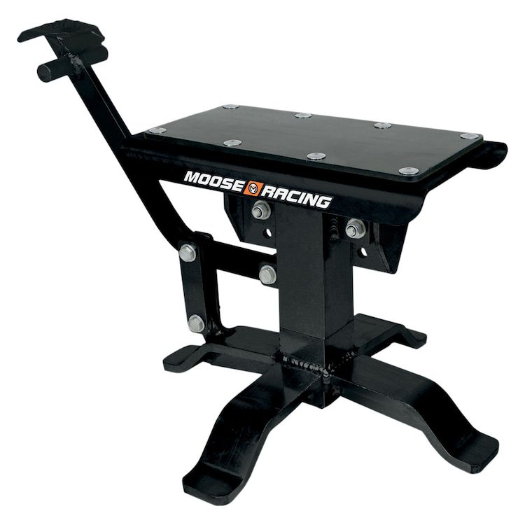

How well does a lift stand like this one work? I'd like to have something portable and useable solo in the field.
Re: bike jack
Great suggestions fellas. I have a stand like the Moose Racing one shown by Bill. I use it for a pit stand for my modern SX bike - not that I'm no longer strong enough to horse the thing around :-). The problem is that in its fully down position, its still too tall to slide under my Hodies so really, it provides no real advantage over a milk crate.

The steel milk crate gets extra points for holding the gas can when inverted.........

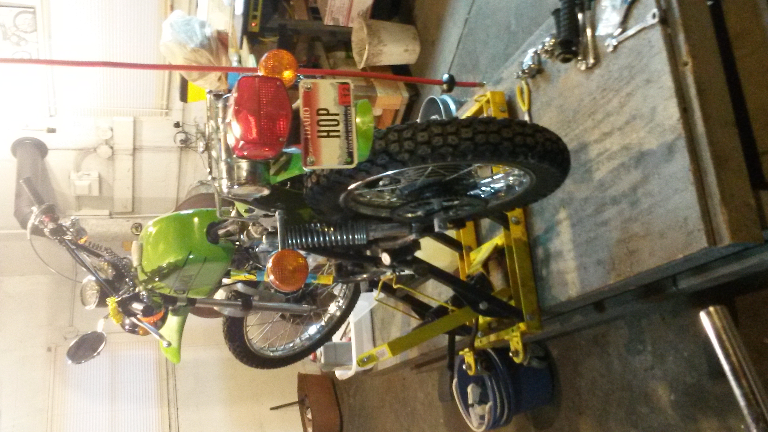

I have used the ATV jacks like the yellow one shown for many years,I like the fact that you can tie the bike or frame down and move it around as needed,lifts high enough to make it ez to work on your bike while sitting on your old stand (mike crate) and both wheels well off the ground
Re: bike jack
How do you strap the bike to the ATV jack? I know its a hassle, but a picture of the bike secured to the jack would be very helpful. Thank you!
Posts: 4870
Re: bike jack
I use a ratcheting tie down strap. Raise the bike, then tighten the strap!
Re: bike jack
Do you loop it over the seat, through the frame, or over the handle bars?
Re: bike jack
Matt, the lift has loops to attach to tie downs and the other ends to whatever. Actually I've never used them as the rig seems stable on a good floor even with the Yamaha XS-650 on it. It rolls around the shop nicely and can be stopped and stabilized with the hand screws.

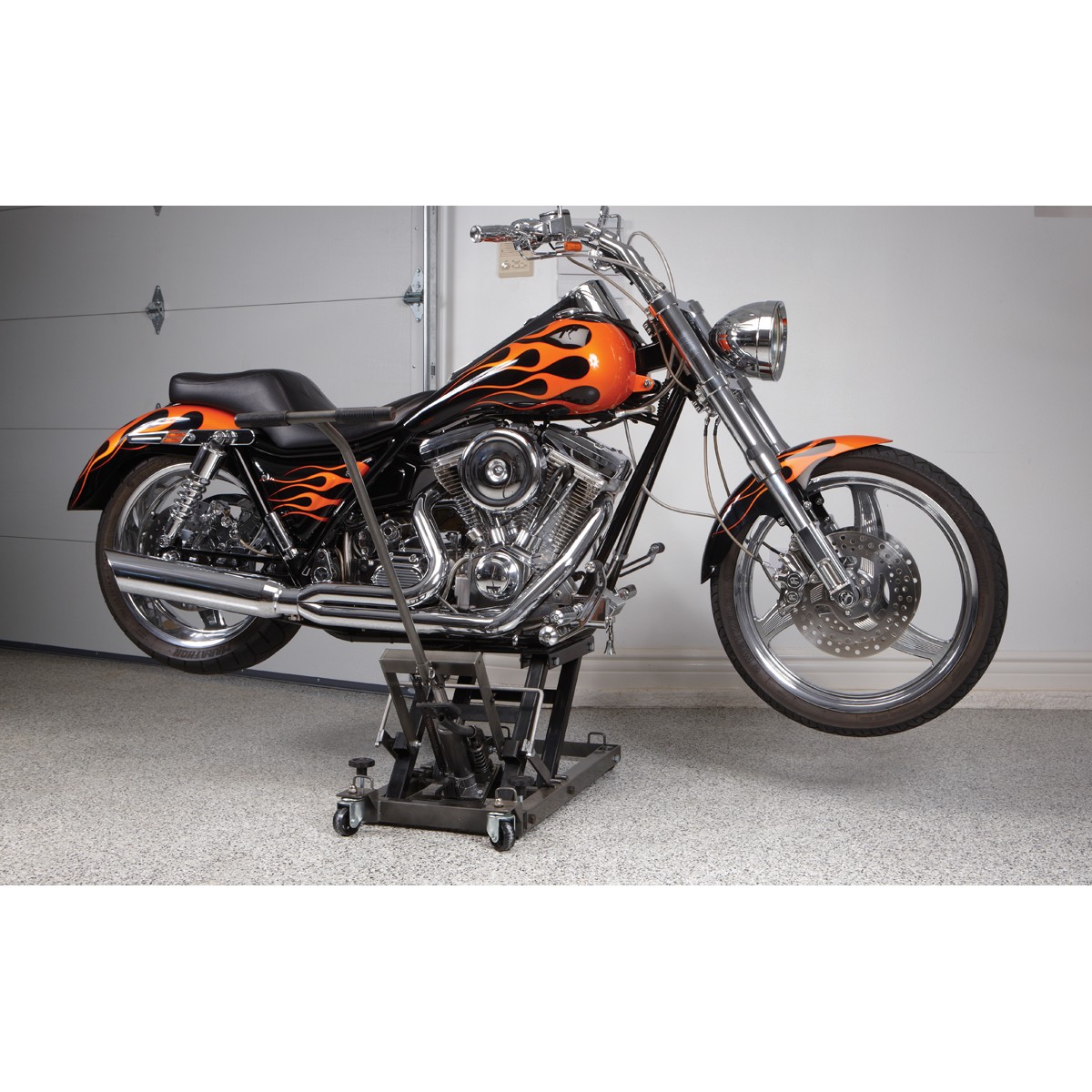

Here's another picture from their site. SALE! $89.95!
NOT my Harley!
NOT my Harley!
Harbor Freight lift
Harbor Freight lift

That's just great, Max. Thanks for the (as always) awesome images. Here's the good news - we just saw the grand opening of a Harbor Freight store here in our town and I'm going to march right in there and get one of those ATV jacks. I already have their bike lift table which is almost always festooned with the bits and pieces of the latest project so this ATV jack looks to be the ticket when another stable hoist is needed. Now to find one of the stands that Rick uses trackside and I may just retire the Plastic Hometown Dairy milk crate once and for all :-). As alway, thanks to everyone!!

I should mention that the hydraulic cylinder on the Harbor Freight device is really crude. There's no really smooth let down but it does have a series of safety stops that engage if needed. Check it out at the store if you can. It all works but could really be a good lift if they would address that feature. It is only $90 and does what it's supposed to do albeit a bit klunkily.
