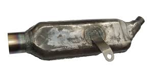

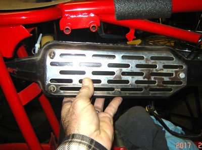

Does anyone have a clue on what's inside these Bultaco things?
Re: Day One - New Project
If they are anything like my Yamaha TY muffler, there is a maze of aluminum walls inside and some fiberglass packing. One of them (the bottom one) looks like it might be a regular muffler, with a perforated tube surrounded by fiberglass packing.

The first two should look like this one inside.It is from a little bit later model(Bultaco) so a little different shape,but they should have the same perforated tube running through the middle and should have packing.
Your third photo looks like an after market from Sammy Miller and as said is probably the same internally.

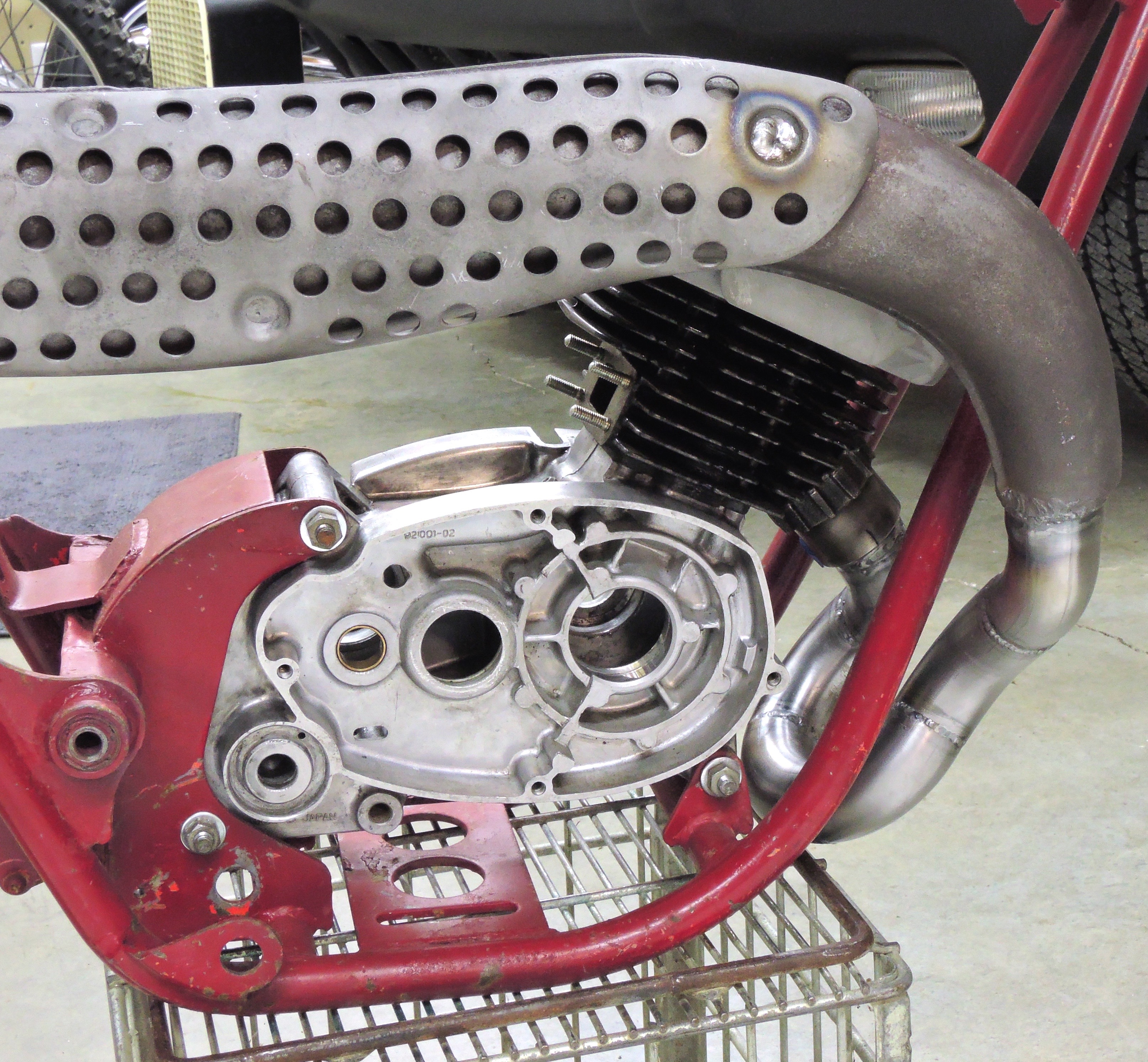

After robbing the reed assembly off of this project (actually for the better) for the 2 the Max project, I still haven't figured this exhaust thing out for the Day One project. Buy or build? I did find this drawing and a possible Bultaco muffler that might be adaptable. I'm not quite sure what's going on inside these things. Any comments, ideas, dimensions or drawings? The header pipe now is about 20 x 1.5 inches. Just questions. :roll:
Aftermarket Bultaco $140
What's going on in here?

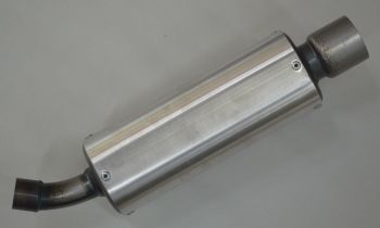

More thinking, right or wrong. I keep trying to visualize building a trials type muffler out of something. After looking back at this picture it struck me. :shock: Why not gut and cut down the present muffler and modify it as the drawing above? Everything is already in place. I think I'll plot and think on this awhile since I have more than one project cooking. Might work!
Drastically shorten to a trials muffler?
Plenty crude but kinda like this. The blue tape shows where the perfed pipe would as in the drawing above. All quite doable with more info on what's going on. I read that there is some sort of circulation going on inside the unit. Some starting dimensions would be needed and a picture or diagram would certainly help. How does all this match at the ends? Still thinkin'. :roll:

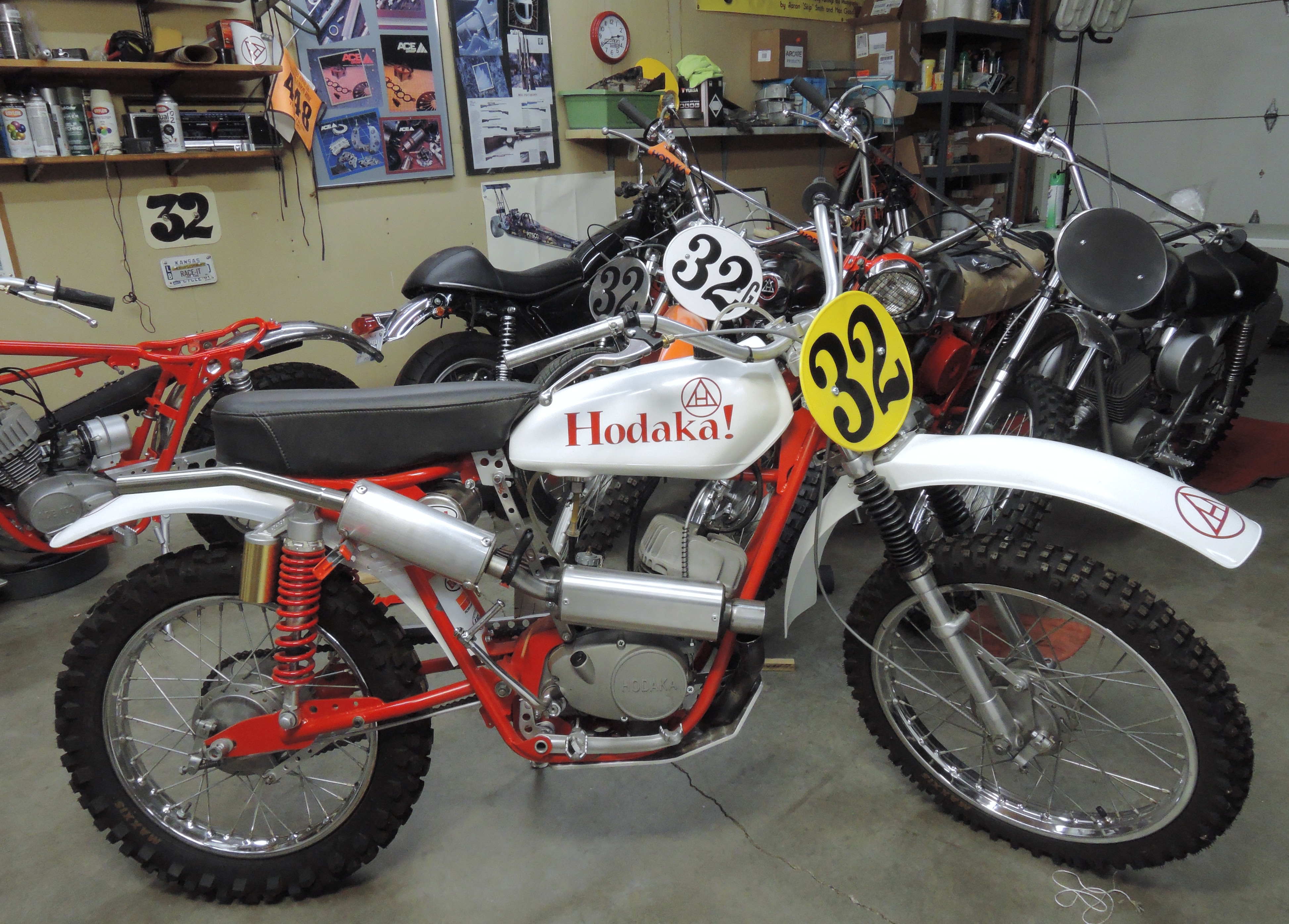

My wife recently introduced me to Facebook which took me to the Hodaka Fan Club. I'm getting some more mileage on the Day One Project with a daily post on the history and progress of the build. Fun again!
Folks there seem to be enjoying your write ups! Pics, as usual, are great! :ugeek: Victor

Probably should start a new subject on this old project from years back but this will bring it to the present one more time. Updates with new ideas particularly in my exhaust thinking. Always gathering parts and I may just put a stock Ace 100 engine back in for plunking around and playing with this exhaust. Probably never to compete seriously but every stable needs a slow creeping/crawling log jumper. Some numbers on pipe design for trails noted, torque the idea. Header length a factor.
Seems a legitimate question. How does the engine know how long the header pipe is if the muffler has the same inside diameter along its length? About 22” on this header pipe in this primitive mock up puts the muffler about here. This is the most feasible way to put this puzzle together so far. Careful here, it’s just balanced on a stick and clamps but seems to fit best this way. With obvious adjustment needed course. I want to use this header design because it makes the bike different and I already have a lot of time in both the header and header guard. Not gonna change at this point. Discussion? Maxie
