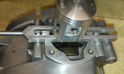

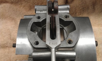

viclioce wrote:Ed. You can make one & send it to me? LOL! I only have one piston to go for now! Would have been handy 3 Pistons ago! : D Victor
All you need to do to get a tool similar to Ed's, is to go to the nearest music store and get one of these. It will give you a different way to "tune" your engine.

Necessity is the father of invention.

Bill! Does it have to be an E320 or will an A440 work too? LOL!!! ; D Victor
Re: The Road Toad Starts Today!
Depends if you are setting up for trials or flat track respectively:lol:

viclioce wrote:Bill! Does it have to be an E320 or will an A440 work too? LOL!!! ; D Victor
I would highly recommend the C 512 tuning fork.
This will help in avoiding "flats" caused by " sharp" objects.
Tom
naturally
Well you guys gave orchestrated good reasons for the tuning fork! ; D Victor
I'm not trying to blow my own horn here, but I could string this along forever.
