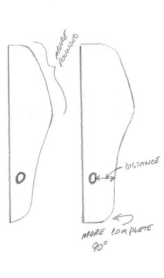

Your best chance at identifying a narrow tank from a photo is by looking at the underside and it's lengthwise profile. But I will say that unless you can actually go "hands on" with both and do a side by side comparison, it is difficult to see the difference in photos.
I drew a picture of what i see when looking at the two side by side. It's not "to scale" and the features I look for may be a little exaggerated for emphasis.
From previous postings about Hodaka tanks it's been highly suggested that these tanks were more than likely hand-made and they are not all exactly the same, which makes it even more difficult to identify a Narrow vs Wide tank from photos.
