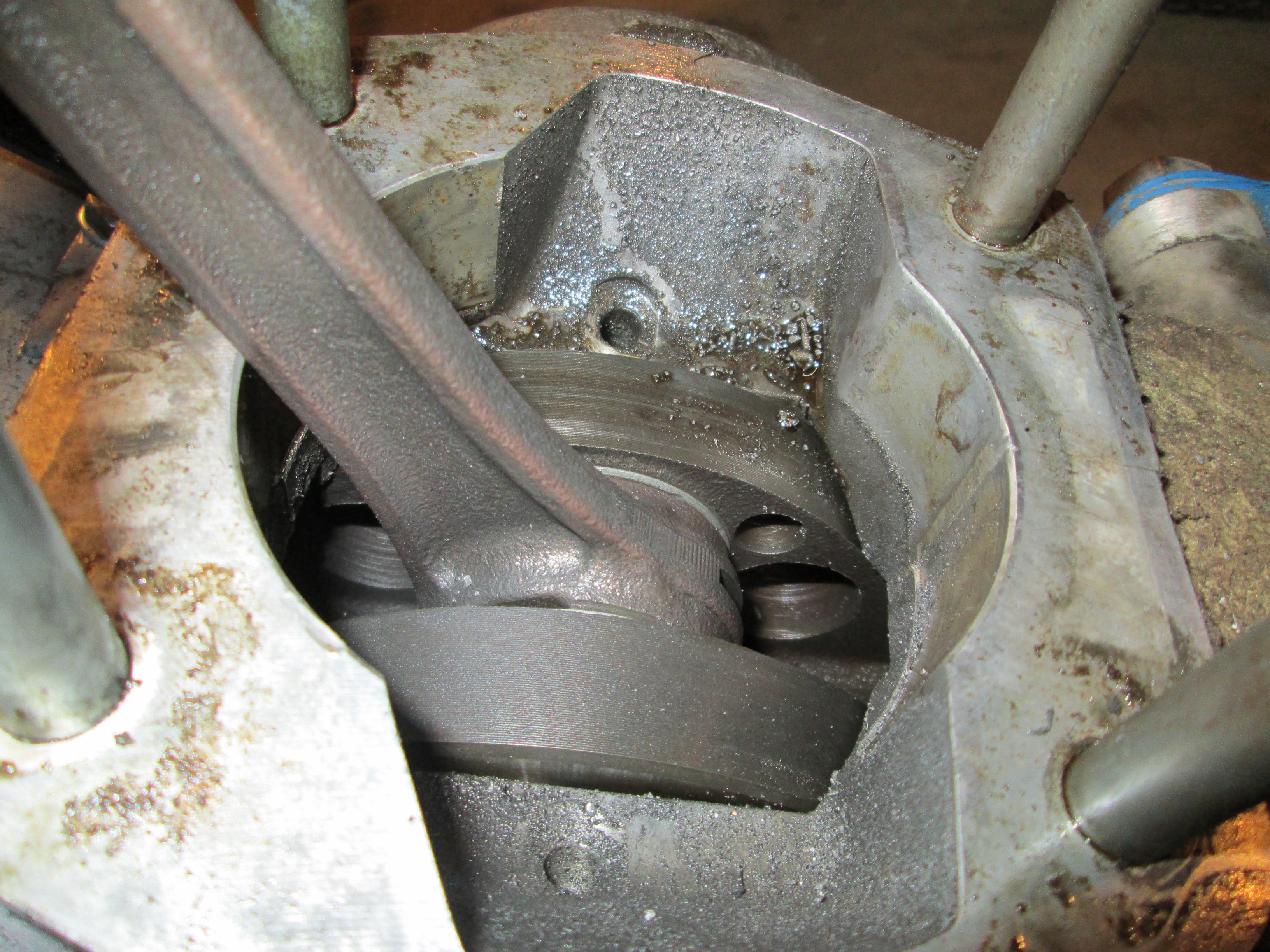

For reasons unknown, so far, my 250SL holed its piston yesterday.

Better split the cases. There's lots of debris in the crankcase, including some piston flakes measuring about 1/4" x 5/16".

Yes, needs to come apart,

Yikes! So much for Max's theory that all the debris went out the exhaust.
Once the piston failed the engine was no longer a pump. Strangely I don't think I ever saw that in my motorcycle career. I suppose that most engines seize before they get to that point. Live and learn on my part.

Not only the hole, but the heavy scoring on the side. What does the cylinder look like?

When I see a photo like that, it always amazes how much damage a piston can take before it gives up the ghost.

I'm amazed how the proper (or improper) fuel air mix can generate a flame hot enough to melt aluminum. It's certainly a graphic picture of what happens when things go wrong in the mix department.

There is only one thing that can cause destruction on this order, and that is ignition. In this case, setting the ignition to 1976 standards and using 2016 gas. As pointed out be Rich Gagnon, the 250 CDI system advances ignition at higher rpm. If the guy was running 110 octane and set his ignition so that at its farthest advance, it was no more than optimum advance for high rpm, he could get away with running hot down the highway.
As it is, what you see in the photo is classic stuff. The erosion on the exhaust port side, toward the camera, is detonation pure and simple. That means he was running crappy gas with too much compression/ignition advance, i.e., stock settings on today's gas. It doesn't matter if he thinks he is running 94 octane. Have you ever seen 94 octane for sale anywhere in your lifetime? I have not. Then, even if he is buying so called race gas, what is used to make a higher octane rating is important. Modern 4 stroke racing bikes can tolerate modern gas. Vintage 2 strokes can't.
Then, too, today's gas will absolutely not hold its octane rating after sitting in a can or gas tank for weeks at a time. It may or may not have the rating it is given when pumped out of the ground, but it starts to evaporate immediately. Guess what evaporates first. Volatile additives that make octane. Tetra Ethyl Lead used to stay in gas indefinitely. Modern junk doesn't. Now we see everything from ethanol to MTBE or toluene used to bump octane, and none of these things stays in gas because of evaporation. Add to that the guy lives at 6500 feet where vapor pressures are reduced, and gas evaporates immediately.
Just the other day I took the carb off my Hodaka to look at the jets. There was nothing in it but oil sludge. Every bit of the 91 octane pump gas was gone. It has been sitting unused for about two months. Even when I ride it regularly, I can see gas flow to the carb every time I open the petcock. Thats because the gas that was there just the other day is gone.
Point is, this has NOTHING to do with oil mix. No one I know uses 35:1 but even if this guy does, so what. 35, 32, 40, whatever. If the oil was too lean, it would score the piston skirt, not burn a hole in the piston top.
So look closely at the photo. You will see two distinctly different, but closely related problems that occurred in sequence while running full bore down the highway. First, detonation which ate away the front of the piston and started to seize the rings, because this situation was allowed to proceed, full bore, for several seconds, the ignition advance issue raised heat to the point of pre-ignition, which is far more dangerous than detonation, but it was the detonation that ran away to the point of pre-ignition. Detonation and pre-ignition are caused by the same things: advanced timing, too high compression for the gas and/or too low octane for the compression.
This bike was set up wrong. Probably but not certainly, the gas was bad, and certainly, the guy was pushing his ride down the highway at full throttle. He should keep in mind that 1) he is riding a 40 year old bike; and, 2) he is NOT riding a highway cruiser.
The only other issue I can think of that would lead to a catastrophic failure like this would be a failed dry side crank seal. This, too, might lead from a solid ride to a failed engine in a matter of seconds, but he will have to inspect the seal to know.
His assertion that the float loose in the carb caused this is wrong. The lost float would do little to harm the running other than jamming the float so it overflows. Otherwise, it was just in there. Had nothing to do with a holed piston.
