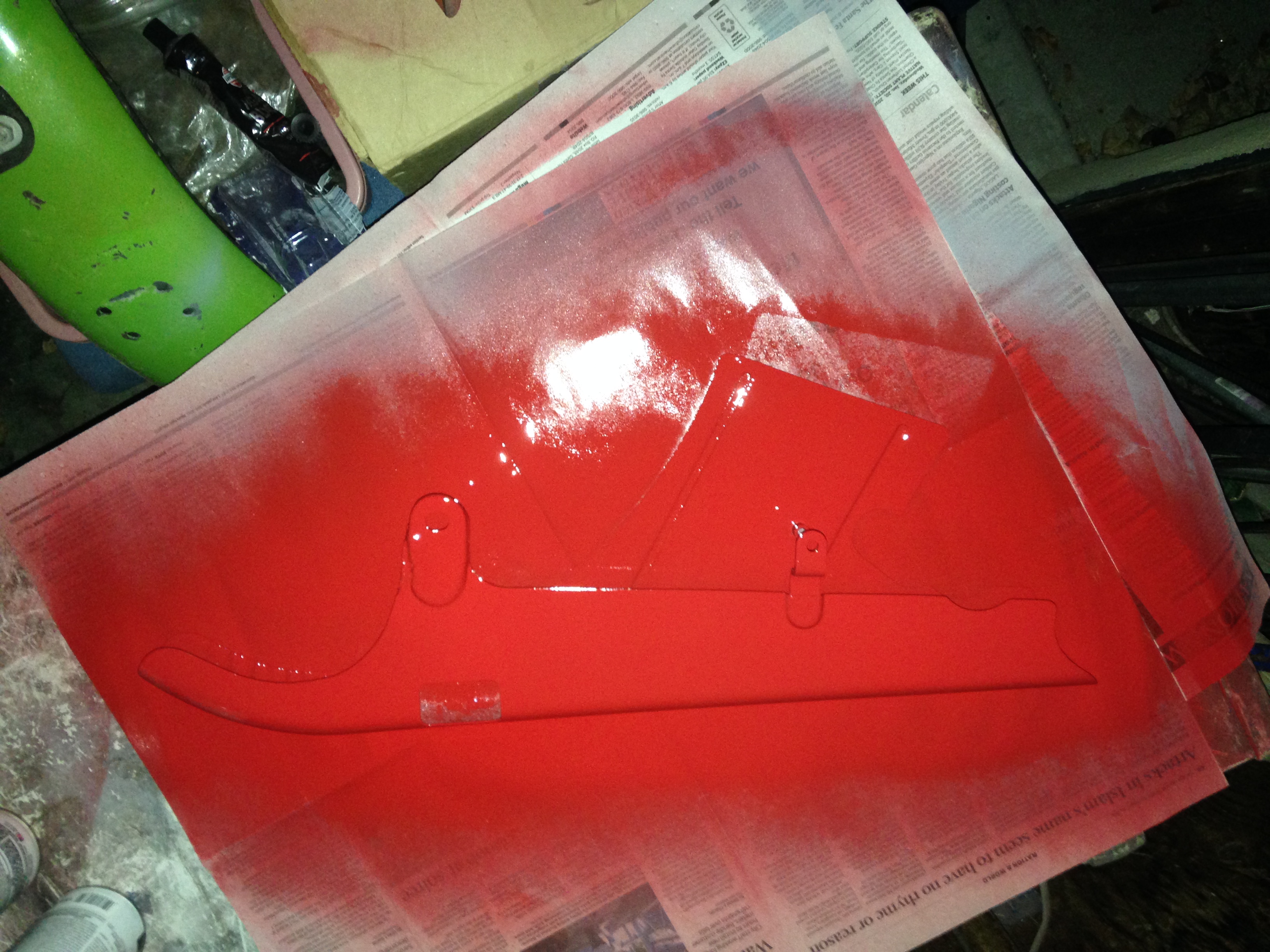

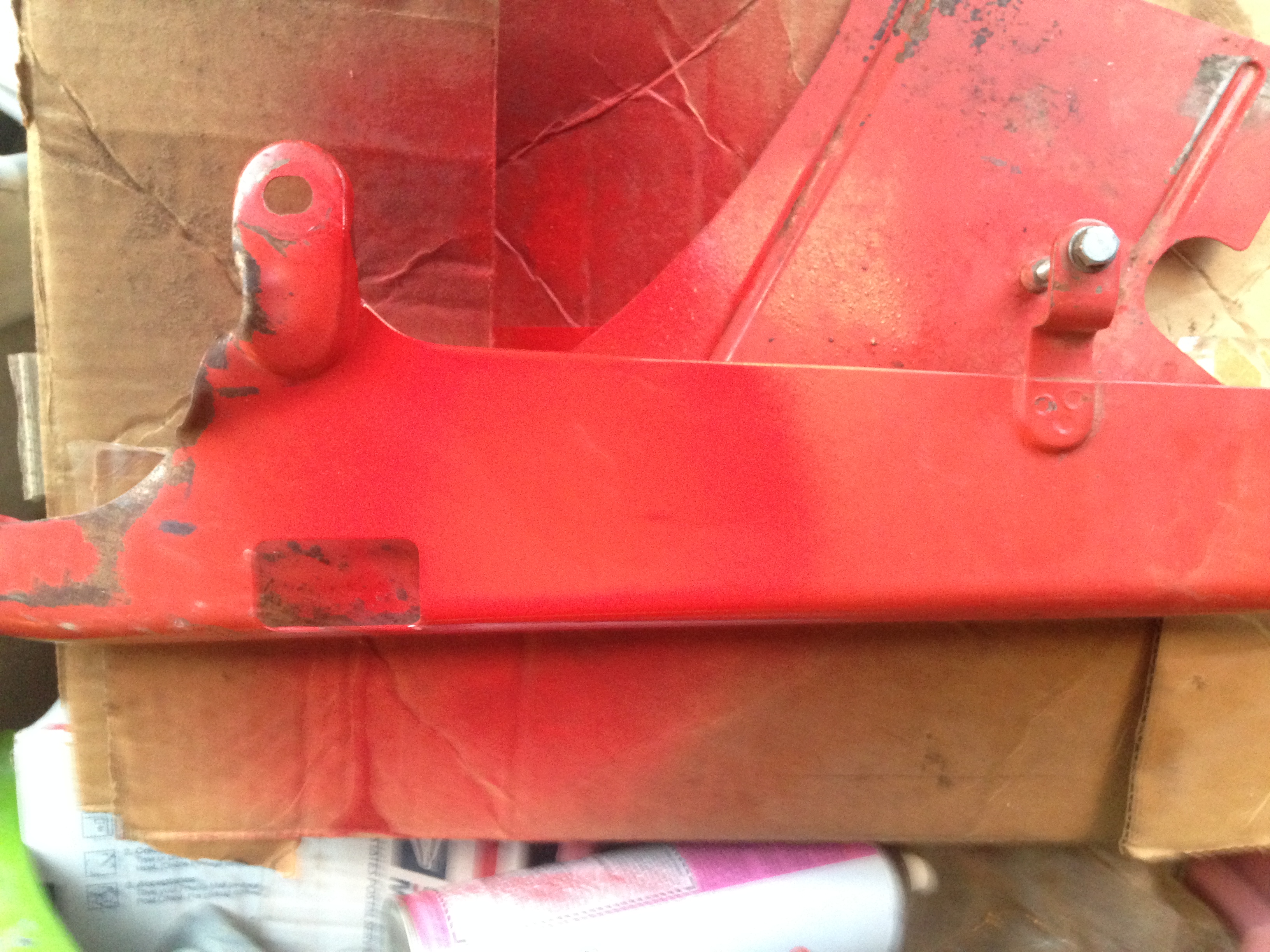

Well, I think I found a pretty good color match. It may not be exact, but I think it looks pretty close. Especially when you consider fade and chalking of the OEM paint. Here's a photo of the Ace 100 chain guard which I cleaned and gave a quick coat on a portion of it. Tell me what you think?
Of course, I'll be stripping the old paint off and putting down a coat of primer first. But I think this may work well! ; D Victor

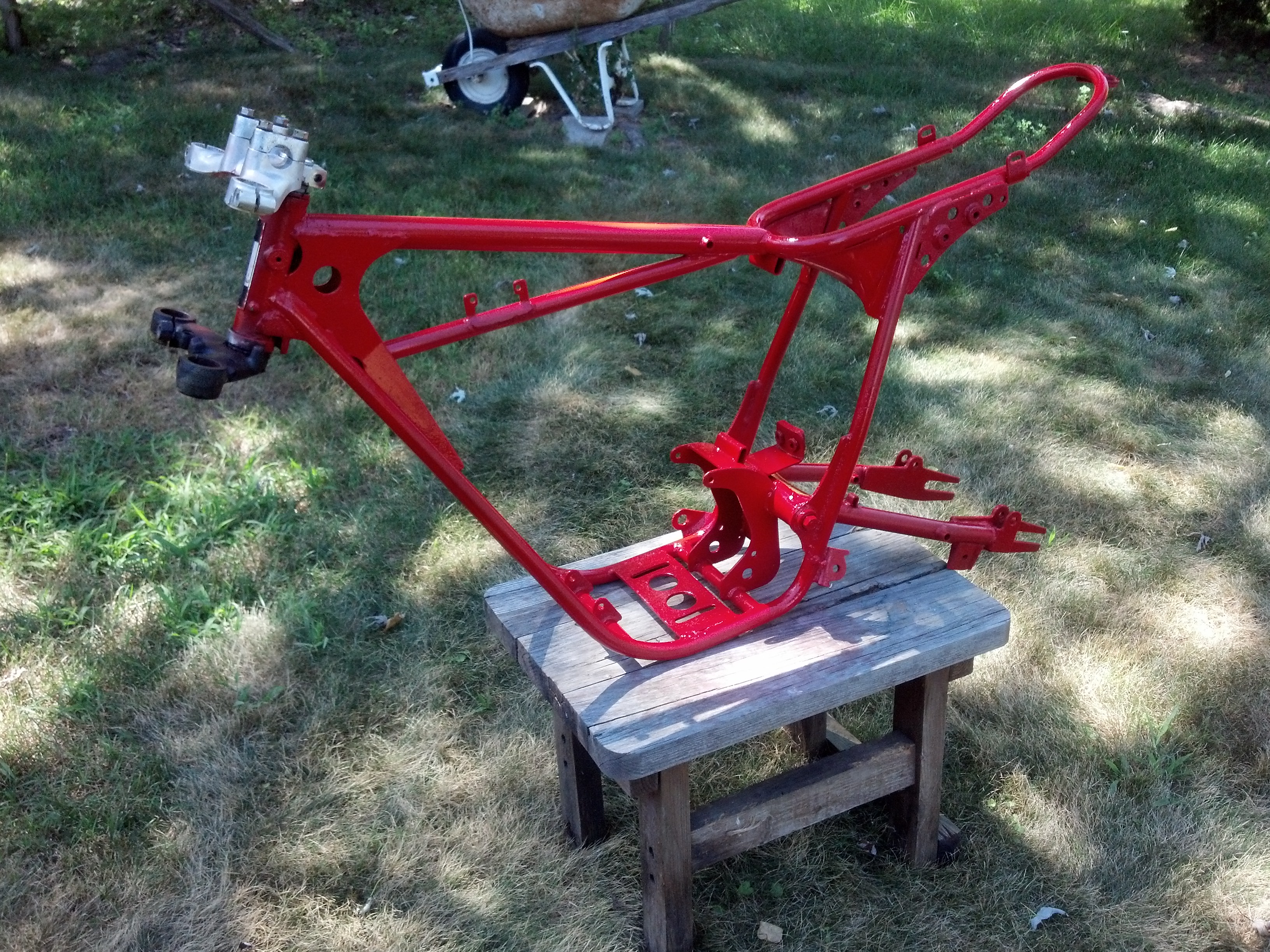

Rustoleum High Performance Enamel red (silver can) is very close to "proper" color on chainguard (laying in frame) that was already painted with SH paint when I got it. I think I bought it at Auto Zone but it's been awhile. Reasonably run- and splatter-resistant when applying, pretty tough when cured.
Imagefirst coat on frame by Lee's CB, on Flickr

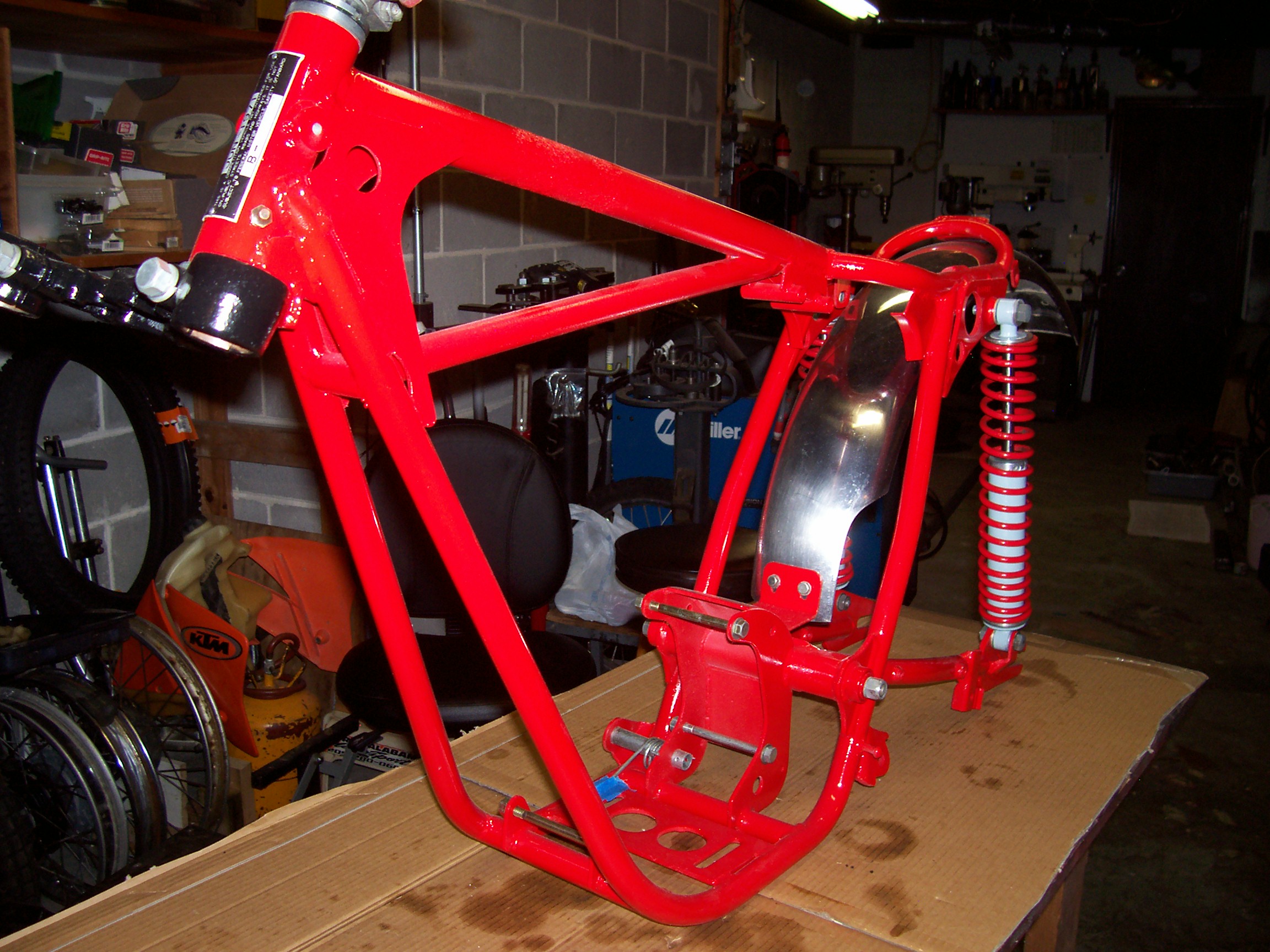

My Grandson and I are doing a Dirt Squirt project for the Resonator Revisited. I bought some Rustolium Apple red enamel for all the red parts, air cleaner, frame, chain guard, etc. I think this type has primer already in it, but of course I used primer first. Look in the RR for the next installment. Probably late spring. The weather will be nicer then.
DS frame drying
DS frame drying
paint selection
paint selection

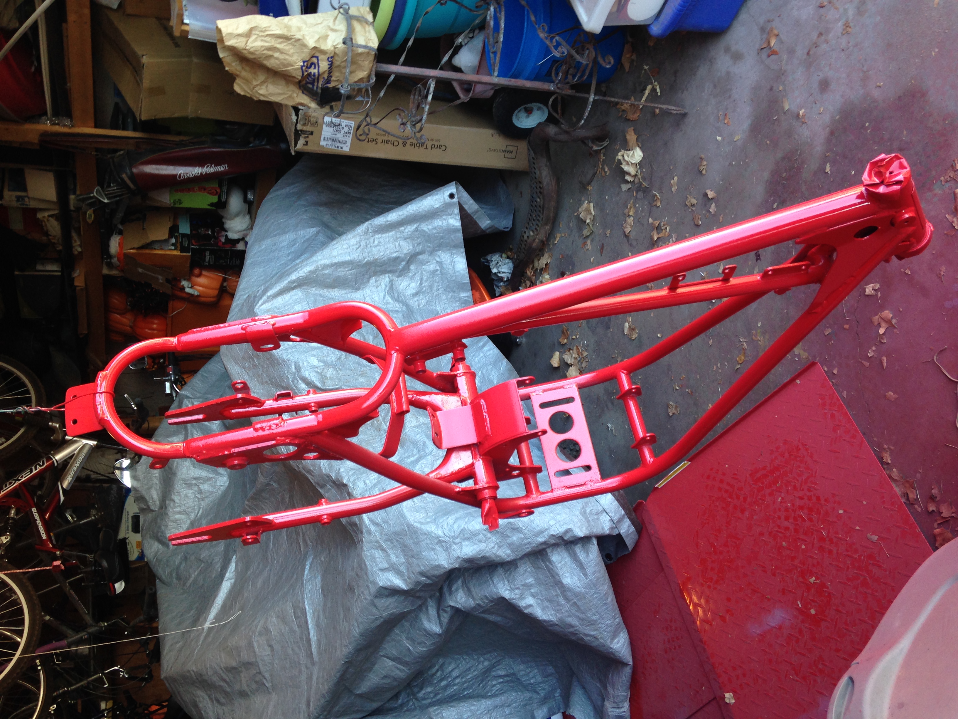

Here's today's fist result with the paint mentioned above. This is after metal manipulation and primer. Still need to paint the other side tomorrow. ; D Victor

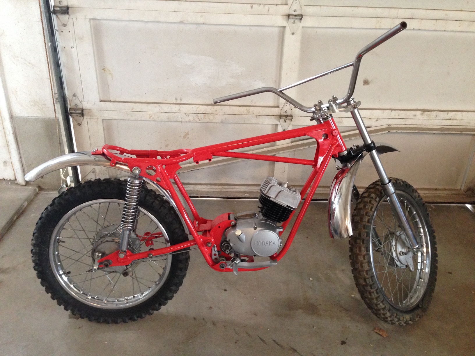

OK! My Ace 100 frame is now Red! Do you like the color? ; D Victor

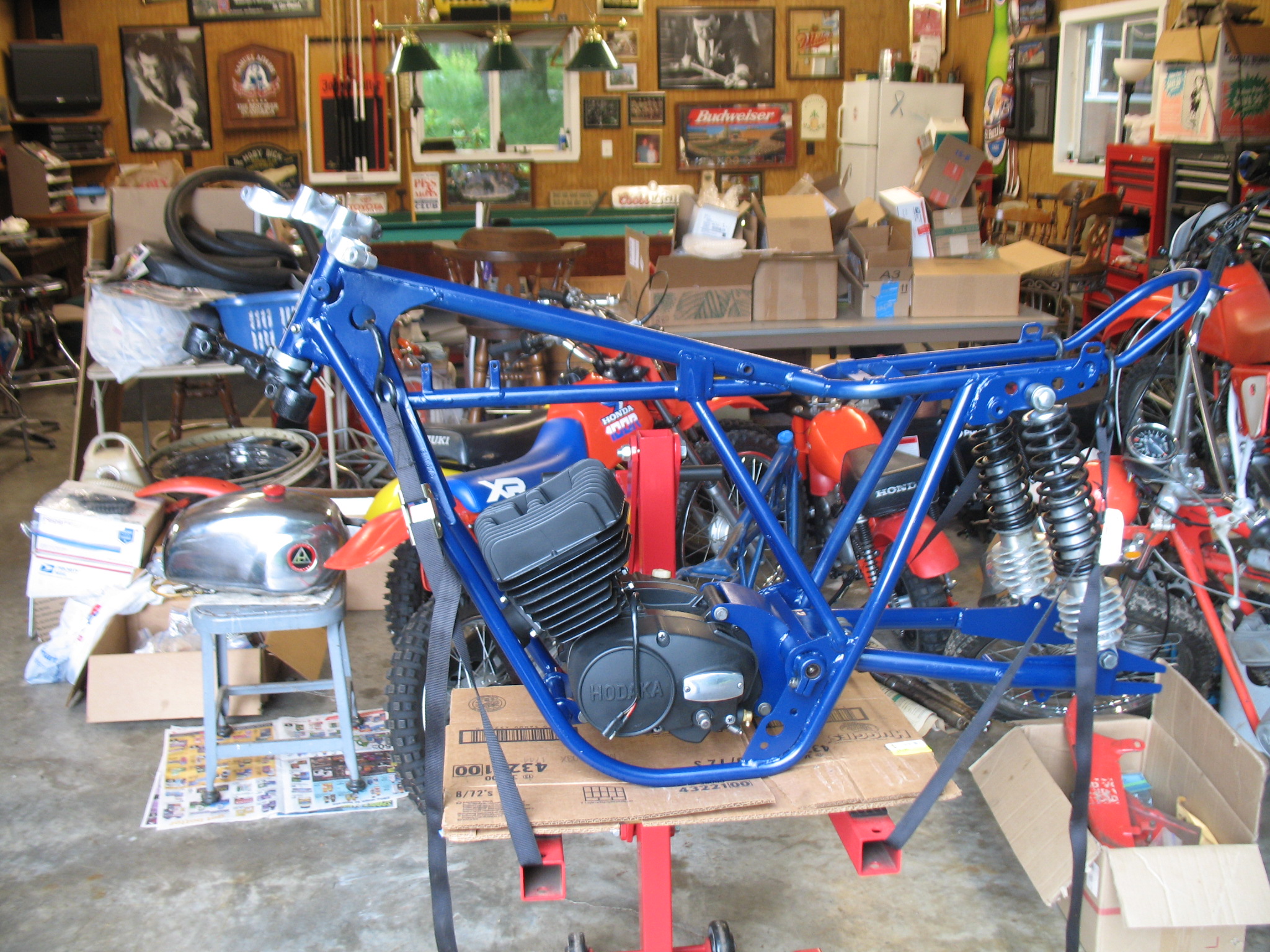

Post by JackM »
My Super Rat 98 project coming along. Rustoleum Navy blue on the frame and PJ1 Fast Black Satin on the motor.
