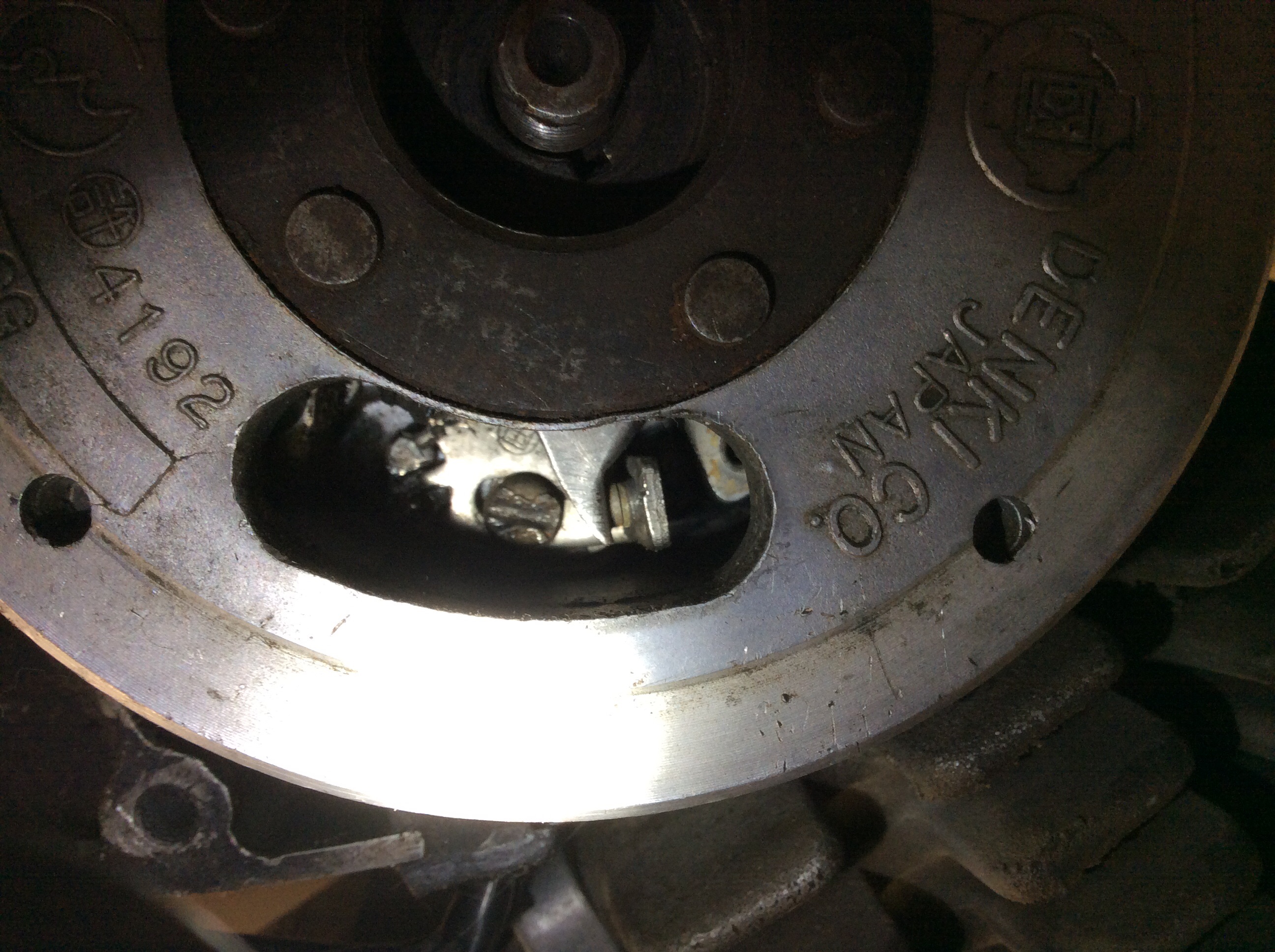

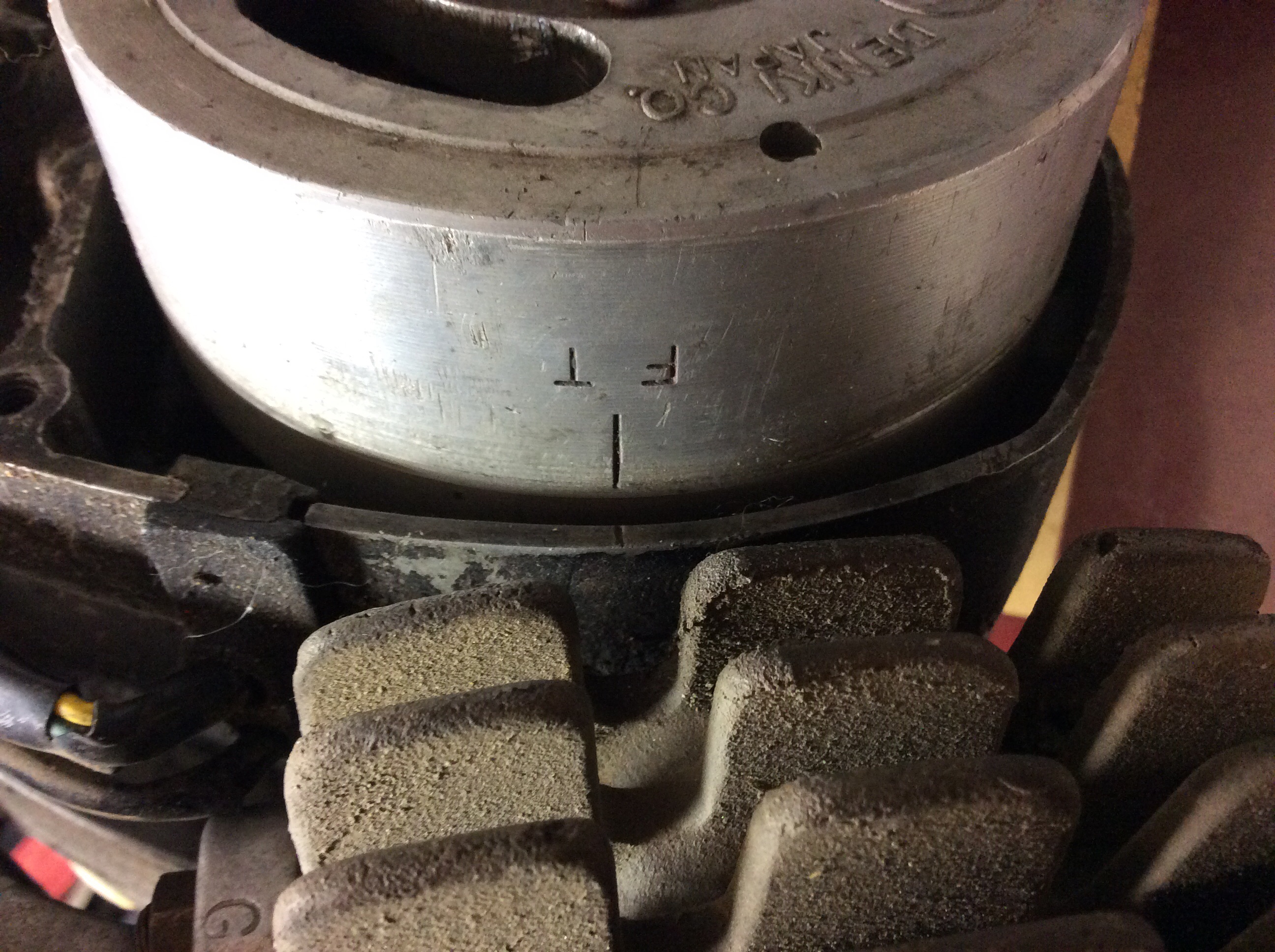

If you don't have a magneto puller for the Hodaka, don't try to take it off. Just check the points through the witness hole. Timing mark is on the flywheel and one on the engine case. Line them up and take a peek. The points should just break open at that point.
You can just see the points through here:
